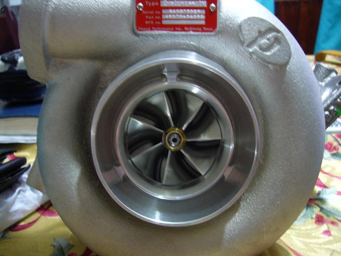

my friend just got his turbo , the 80mm and we noticed that the blade direction on compressor is the oppiste way on this new turbo , u can see on the pics , how directions on the blade are totally oposite , is this normal ????????????
this is the turbo he got

Compare the exhaust side too
thanks i did check , and the exhaust side is in the correct direction , i really dont want to think fp send me this turbo bad assembeld

That looks like a big fat oops!!! Im guessing you got a X wheel accidently put on an 8/9 red......
let me compare
ur right its the evo X i just compared on a pic on an evo X and they turn in same direction
Thats why I suggested it... the X spins the opposite direction from the 8/9, the same direction as the old 1st and 2nd gens.... I would guess the wheels are the same size and it would be very easy to make an oops....
The good thing is FP is first class and will get you taken care of just give them a call or PM.
would be a good idea for people to go check
Just checked. Mine is not like in your picture. Mine is like the one picture you took off FP's website.
