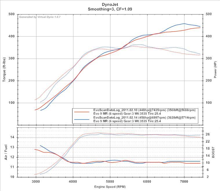

This is what I found when I switched from a Titek O2 housing to a JMFab O2 dump on my IX w/Red...
The red line is the Titek tuned @26psi...the blue line is the JMFab with no changes (ign, fuel, boost etc.)
The car came on boost a little later but definitely held more boost out the top...
I've since preloaded the actuator a bit more to bring the spoolup back in line.
This is by no means a direct comparison as the 2 logs were taken on different days, slightly different temps etc. This just happens to be the only data I have to compare.

Look at the boost up top! Amazing, a dump should be standard. I wonder how well it'll work at 30PSI.

up top power
thanks for the graph
nice gains up top for sure
