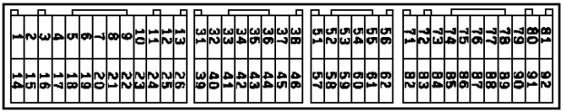

I'm hooking up my Apexi turbo timer one of the wires needs to goto the o2 sensor wire in the ecu can someone help me out where that is?

Try this.
Attached Thumbnails where is the o2 sensor wire in the ecu?-ecu-harness-evo.gif

I think it's #76

It should be pin # 76
(When you look at the wiring harness, look at it from the back of the plugs where the wires come out)

Pin 76 is the 02 voltage wire
