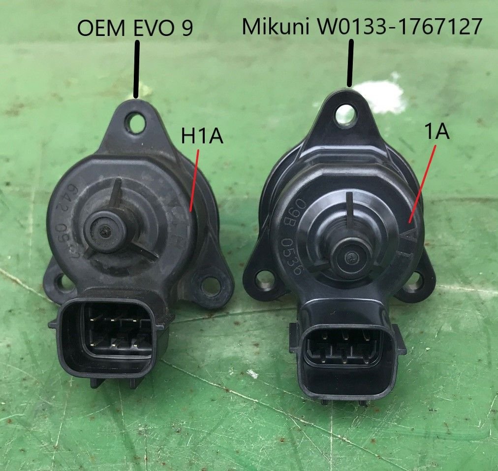

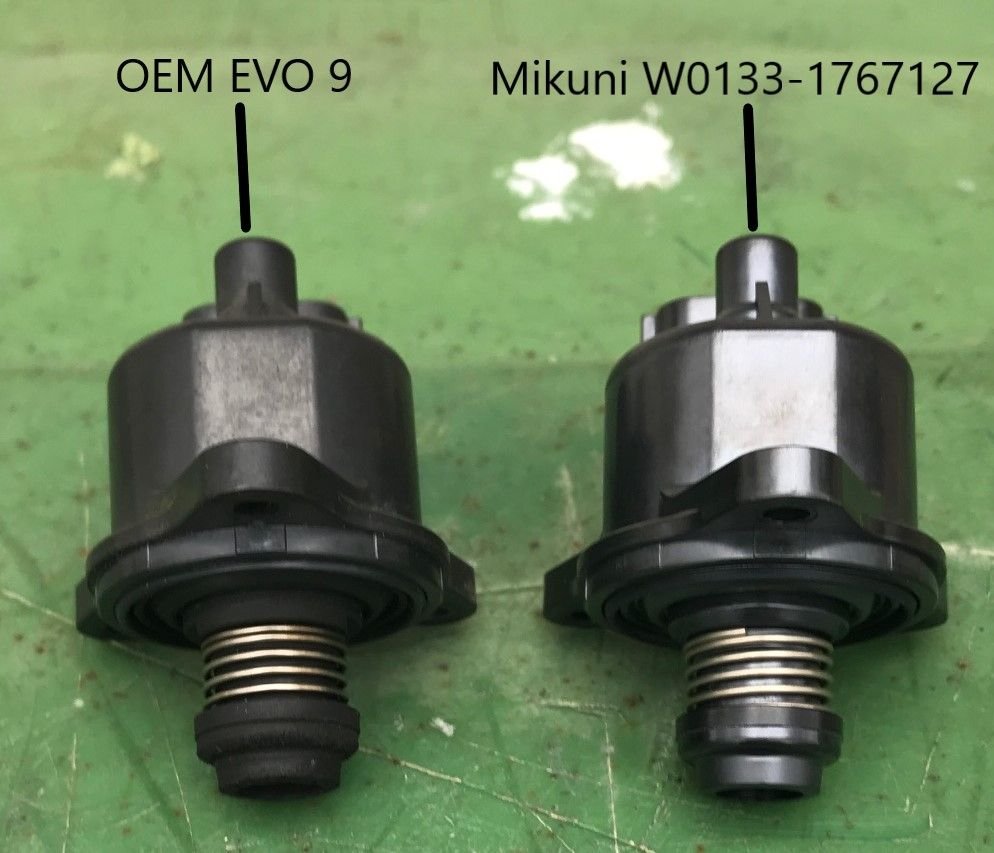

For some reason on my car the SAS mode doesn't always work correctly so I can turn it on and the idle actually increases, which it should not do if the IACV closes. I replaced the factory EVO IX IACV made by Mikuni with a new Mikuni W0133-1767127, which is $225 from partsgeek. If you can't get the SAS to work properly when activated then you can simply increase the idle using the factory stop, which should force the steps to decrease to lower the idle. You'll just have to keep doing this until your steps are where you want them.
