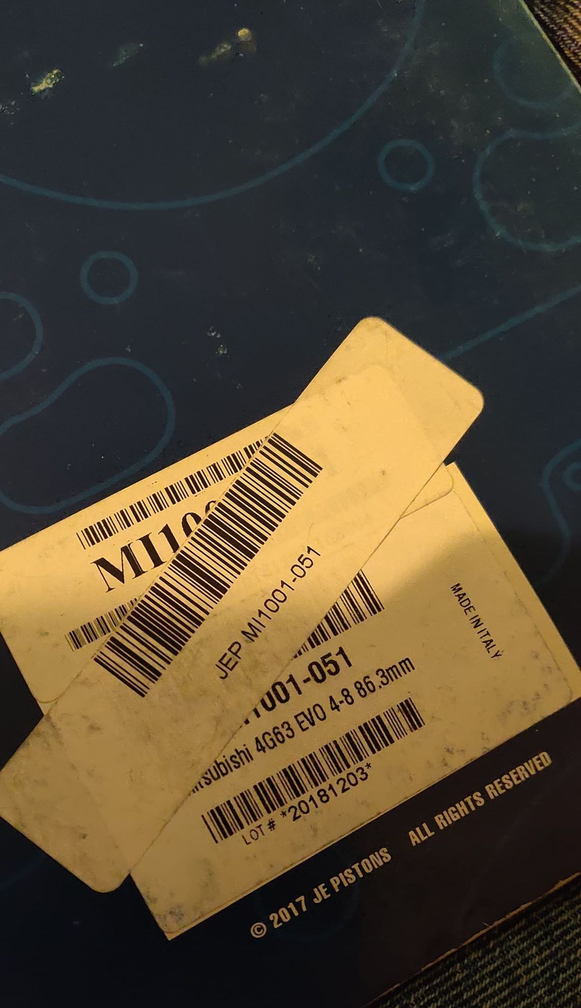

On a similar note I bought a JE ProSeal 0.051" headgasket for $80. It looks like it could be a decent aftermarket headgasket if you don't want to spend $300 on a HKS or $150 on a Cosworth. Comes in 87.3mm for 4G64 applications too, the one I got (MI1001-051) was a 86.3mm bore. 4 Layers MLS w/a stopper layer and made in Italy. I have a feeling they're actually made by Athena Racing Gaskets (P/N 338017R looks IDENTICAL to MI1001-051 down to packaging and both gaskets have the same "features").
