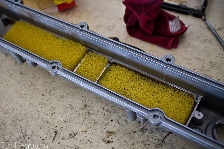

What about this idea, putting fuel cell foam in the valvecover:
Or instead of putting it in the camcover put it in the catchcan?
Complete article here: http://run-it-hard.com/2013/03/contr...thing-part-ii/

are those rated for high temp? since fuel cell don't get that hot.

I would be concerned about it acting like a sponge, or is it more like the properties of steel wool?

If it would act like a sponge how can they fill a fuel tank with 80% if this foam. That would not work.
This kind of foam is also used on many bikes as part of the crank ventilation system.

What is the purpose of the foam in a fuel cell? Looks more like mesh then foam. Was assuming sponge from the name. People have been using steel wool inside the catch cans to separate the oil and water from the air. It may have a use there, not sure how it would do inside the valve cover.

Foam in a cell keeps the fuel from sloshing so you don't need to run baffles. The stuff is highly porous. It would really help condense the oil out of the air.
But, I don't see the point of this. I barely get any oil out of either valve cover fitting.

The normal purpose is to combat fuel surge and safety for explosions when the fuel cell ruptures in a accident. I would not use it in a valve cover, although it is possible, I might try it in the catchtank. You can fill the whole catchtank with it. I think it will help a lot seperating oil from the air.
Since I vented my rear port to atmosphere it has had about 1/3 quart show up in my catch can over the last 30-40 pulls or so. Front right has no oil, just a tiny amount of moisture from the humidity.
Would you use this with a baffled or non baffled catch can?
Or put it in the valve cover where it will also separate oil from air and less oil gets to the catch can. Fuel cell foam is silicone foam, so even though I haven't been able to find a temp rating, I'm sure its good for at least 300*, which is fine for oil in the valvecover. I would probably replace it semi frequently to to prevent it from falling apart and going into the motor.

How would you attach it?

You put the plate back over it and it won't go anywhere.
