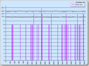

My car makes the "typical" ball-bearing-dance sound, under low to mid acceleration in pretty much the entire range of gears (again, in low-mid accel., not WOT). I use only the highest grade gasoline and not from one gas station (to avoid the possibility of one sample being tainted). A long while back, I had allowed the antifreeze in the RESERVOIR to get VERY low (way under the MIN mark) but the radiator was full as I discovered. I don't know if this had anything to do with it.
I logged with EvoScan and I am attaching some images that I think are relevant to the problem I am having. The only problem is that I don't know how to change the scale in EvoScan KnockVoltage graph, so the number "25" = 1V, FYI my max was about .97V if I remember correctly. KnockCount was MUCH higher, which is what makes me nervous.

I logged with EvoScan and I am attaching some images that I think are relevant to the problem I am having. The only problem is that I don't know how to change the scale in EvoScan KnockVoltage graph, so the number "25" = 1V, FYI my max was about .97V if I remember correctly. KnockCount was MUCH higher, which is what makes me nervous. .
Knock voltage tells us NOTHING, useless. Knock sum tells you alot, especially if spark timing decreases alot. 0-15 counts here and there is normal, but continuous spikes every 5 seconds with noise you can hear and loads of timing pulled is not good.
The APS valves significance might be related to the load that causes the problem, but if the problem was there prior to it, then it might not be the cause.
the weird thing is I never seen knock counts that high, I thought they capped off at 36 counts. But I'm not used to reviewing evoscan, I use a much different logging software
I was not aware of the 36 count limit (cap) and I cannot explain why it went that high. I suppose it is possible that I am not using EvoScan's logging capabilities correctly. Hopefully people will continue to add comments so we can narrow this down a bit.

A. The SCALE that EvoScan logs knocksum, is shown at x10. By this, I mean that when you have a knocksum of 3, the scale on the graph shows 30. So, as you can see the map which I attached in the first post where the knocksum level shows up to 60, is actually 6. (IF ANYONE KNOWS DIFFERENTLY ABOUT HOW EvoScan WORKS, IF MY INTERPRETATION OF THE SCALE AND HOW IT WORKS, IS INCORRECT, THEN BY ALL MEANS CORRECT ME! I CERTAINLY DO NOT WISH TO GIVE WRONG INFO OR TO SHOT MYSELF IN THE FOOT WITH MY CAR).
B. I logged my knocksum level while standing still, but varying the RPMs, by holding steady at 2000rpm, 3000rpm & 4000rpm for about 20 seconds each. The max count that I got was 4, which only happened ONE time in the entire 5 minutes that I logged.
