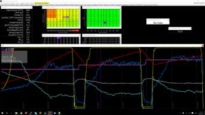

So here's real data, not regurgitated marketing nonsense. I'm not trying to sell you anything. I don't give a damn what turbo you buy and I don't get free stuff from any vendor. Please don't fall into the trap of being a fanboy for a product for a company that literally could not care less about you.
Here's a 2-3-4 hit.
Time breakdown
First 100% throttle 6:50.629
Hitting boost target 6:51.876
Elapsed time: 1.246 seconds to reach boost target (18psi)
Application of throttle after the shift from 2nd
6:53.714
Reaching boost target in 3rd gear
6:54.162
Elapsed time to reach target (22psi): .447 seconds
Application of throttle after the shift from 3rd:
6:56.2586872
Reaching boost target in 4th gear
6:56.8883128
Elapsed time to reach target (26psi): .629 seconds
My impressions? It recovers boost pretty quick. Not amazing quick, but reasonably quick. Stay tuned for my follow up update on the 6870 gen2, which is supposed to be "laggy". For reference, this turbo on a dynapack with a usual ramp rate of 500rpm/sec (what most operators would run) makes boost target in 4th gear at 4900rpm with the pull started from 2000rpm.

Thanks for the info. Very interesting. What was the rpm at the moment the next gear was engaged?

What turbo are those graphs and time breakdown for? What rpm range does it hold boost through?

You are correct, I will post new data but not hot parts have to be changed. The only addition (which I don't REALLY have to add) is a Turbosmart raceport BOV. Technically I could do the recirc valve and vent it back into the inlet, but it's not really necessary and I have a turbosmart bov lying around. I'm super curious as to what the data will show as well, because the marketing about the ti-al wheels certainly struck a cord with me thus the reason I've spent so much time and money testing them out. I'm also going to test a comp 6471 or 6671. This will be with a 94mm exducer compressor wheel as well.
The moment of shifting from 2nd to 3rd was at 8563rpm and re-engaged at 6041rpm. In 3rd going to 4th, 8463 re-engaging at 6476. I had 150rpm of "lug" in 2->3 and 100rpm in 3->4 (that little dip in RPM meaning the RPMs dipped down a hair faster than I caught the gear.
Keep in mind this is on a stock ap2 transmission. I already blew up 4th gear and am swapping in the spare. It does not like 500+ft lbs of torque. I'm looking into sourcing a quaife or g-force transmission for a replacement.
Edit:
Here's the log itself if you're interested in viewing it with AEMdata
https://drive.google.com/open?id=0B6...NyV3l0Y1VPenh3
You can download it here;
http://aemelectronics.com/files/soft...ta_4.01.01.exe

I can state from all my data logs on the S2000 the boost recovery time is between .5 and .75 seconds from wide open throttle with a shift time on average between .4 and .5 seconds to not destroy the stock transmission. It will be interesting to see what the Precision 6870 G2 can do with the only other change being the addition of a Turbosmart Raceport BOV.
So you're judging boost recovery time off a setup that's handicapped by a need to shift softly? Doesn't seem like the best test conditions...
