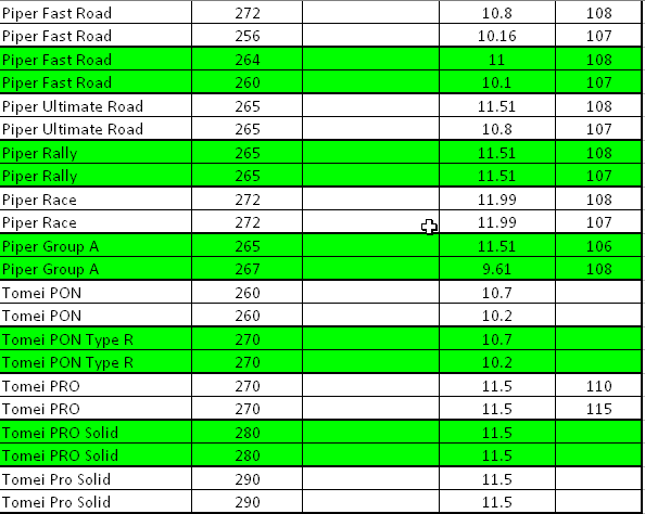

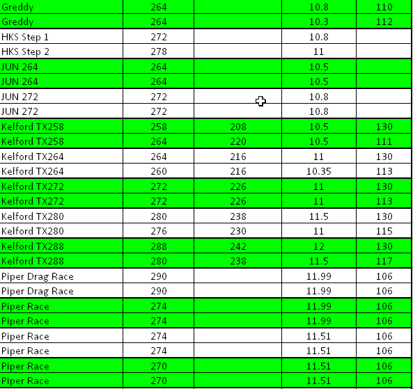

Below is a list of all the popular aftermarket Evo VIII & IX cams w/ published specs. If there are any other cams that you have the specs for let me know and I'll add them. Evo IX cam specs are in the post below this one. Hope this helps
*FP cams advertised duration is for .050" (1.27mm) and not 1mm*

Great update, good to see the new hks 272/278 up there for the IX. Quick question, how does duration of cams affect power band and agressiveness/driveability? ie. kelford 272/272 and the new hks 272/278, more duration for hks but similar lift. What would be the difference between the 2 when installed? Stock IX turbo in my case...

Is there any more info on the tomei 270 11.5mm lift as I have a set at the moment I'm fitting into my new 2.4 motor and need to know at what degree to set the max Lift of the cams to???

Found the info i needed in the end for the tomei 270 procams for hydraulic lifters with 11.5mm lift.
Centreline for intake is 110
Centreline for exhaust is 115 is the OP can add the info to the chart.

Good question, lift is how high the valve opens and duration is the period that the valve is open for. More lift/duration allows more air to enter the cylinder and more exhaust to leave the cylinder. Typically higher lift/longer duration cams are a little rougher, but depending on overlap that can be reduced.
