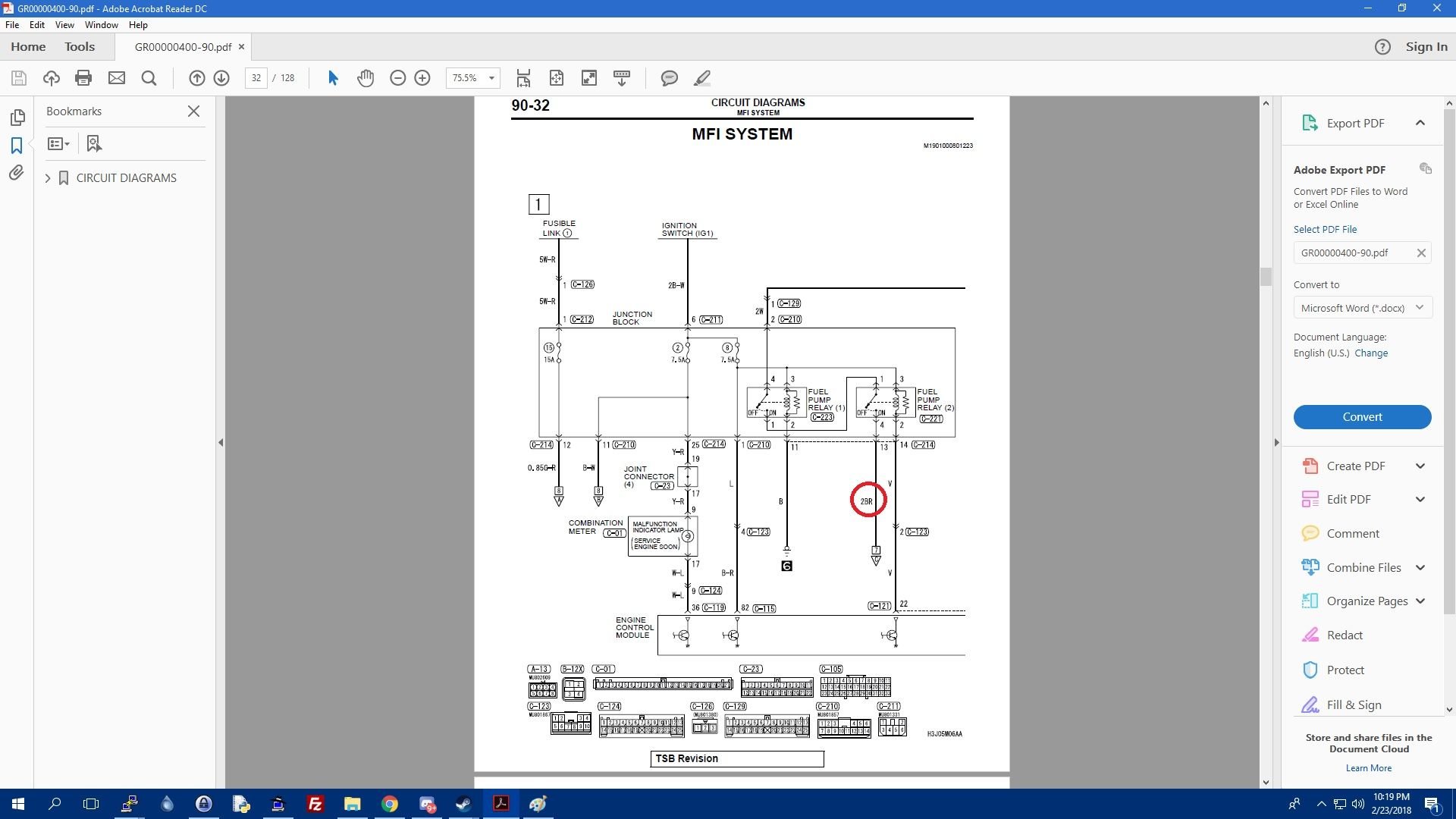

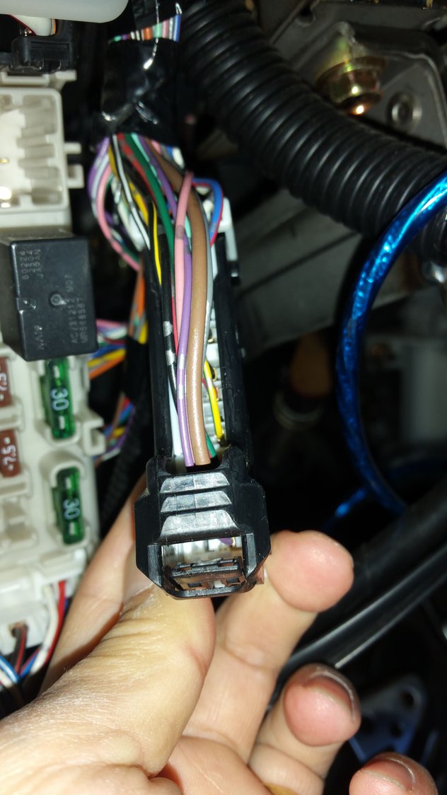

Yup. I figured it out by looking at shape and looking closer at cluster. Although it shows 14 in a row, it's actuall 4, 4, and 6.
this should help

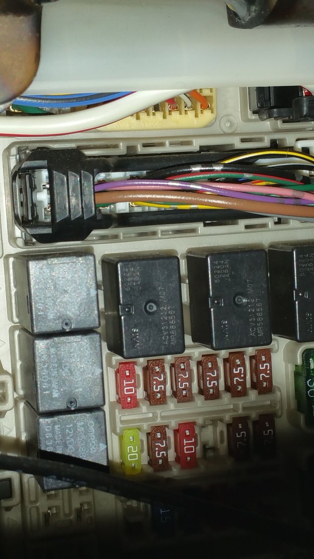

Pink and purple wires are thin! No wonder voltage drops to much at pump!!

based on the wire color codes in the diagram i think the wire should be brown (2BR).

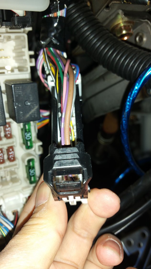

Doesn't look like Brown is connected to 13. Looks more likely connected to 28.
Brown makes sense and looks like 14 awg.

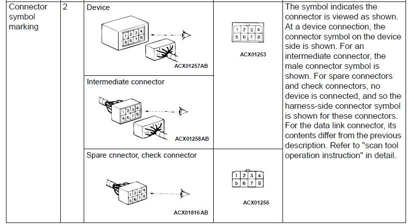

Actually, I read drawing wrong. Pin 13 should be bottom row, 2nd pin:
It was upside down after all.

yah im thinking maybe your picture is upside down, or the diagram is, having done countless car alarms in my 20's that wouldn't surprise me at all. I would usually orient the diagram based on the colors of the wires and their known positions in the connector. So if that brown is second from the left in your picture then that would match if you flipped the diagram 180 degrees.

My picture is rightside up. I took it through the 2 dummy switch covers.
The left schematic is rotated 180 upside down.

So pin 14 is purple and pin 13 is brown
I decided to pull off the cover instead of camping upside down.
Only 2 philips screws and a 10mm bolt in back connected to fuse box.

If you guys haven't done this yet consider swapping Relay #2 with Intercooler Spray Relay. Intercooler relay is probably as good as new, so retire your Relay #2 to intercooler duties.
