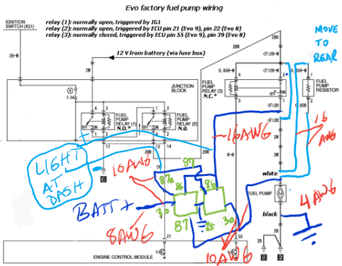

Old Feb 23, 2018 | 01:46 PM
  #251
2006EvoIXer's Avatar
Joined: Jul 2012
Posts: 3,294
Likes: 197
From: California
Excuse me from all this drama.
I'm about to do this for my rewire. Do you guys see any fatal flaws? Thanks!
Old Feb 23, 2018 | 02:00 PM
  #252
Biggiesacks's Avatar
Posts: 5,690
Likes: 708
From: West Coast
i replied in your thread.
Old Feb 23, 2018 | 02:18 PM
  #253
Joined: Jul 2012
Posts: 3,294
Likes: 197
From: California
Thank Biggiesacks
I'm trying to digest and getting heartburn
J/K. I'm trying to follow.
BTW, light would be LED so it can't keep pin 86 on both green relays on.
Old Feb 23, 2018 | 02:28 PM
  #254
Posts: 5,690
Likes: 708
From: West Coast
Yah the normally closed nature of relay 3 is a pain to deal with
Old Feb 23, 2018 | 02:49 PM
  #255
Joined: Jul 2012
Posts: 3,294
Likes: 197
From: California
I forgot that it is normally closed. Crap
I don't want to use diodes for the resistors.
So it looks like the pump is supposed to start up on 12V, then switch to 8V at idle. Then switch to 14V under boost.
Starting the pump on 12V is smart. Less current to draw at highest demand.
