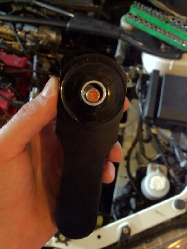

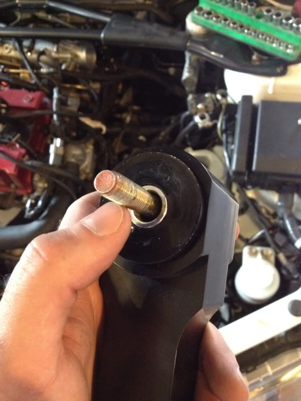

For those of you who installed the rear mount I have some questions.
So I'm in the process of installing the torque solutions rear and driver side mounts when I came across a possible problem with the rear mount.
The bolt I removed from the factory rear mount has a must smaller diameter of the torque solutions mount as you can see in the pictures:
The bolt is a 10mm x 1.25 and is 3 11/16" from the shoulder to the tip.
Now before I actually remove the rear mount I had some questions:
Is there another "sleeve" or something similar in the factory mount that will prevent the new mount from bouncing around?
Is it possible the wrong bolt was replaced when my clutch was installed?
Is it possible the wrong insert is placed in the torque solutions mount?
This mount is a bastard to get out so I think I will wait a while and try to get some answers before I go all in after it.
Thanks for any help.

I visited ace hardware and bought a bigger bolt. Then I took the mount bracket off and made the hole bigger with my drill. I'm sure there's other ways. Hope this helps

I finally got the rear mount out of there.
What did you do for the back/bottom part of the mount? It seems to have the same issue as the top. I'm going to head to ace to pick up some hardware.

Same thing. There are bolts holding the lower bracket on. The rear one is such a pain. I didnt do it on my car but I helped (did it on my own) a friend install his.
We also had to do the same thing for the front lower mount. Torques solutions is a nice piece but they don't care about your bolt sizes.

I didn't bother with the rear due to horror stories I heard of the install. I just did cam side, front and tranny and all the bolts lined up perfect. I did not have to buy a bigger size and they all fit snug.
Perhaps contact torque solutions as all their mounts should fit exactly to OEM spec.
