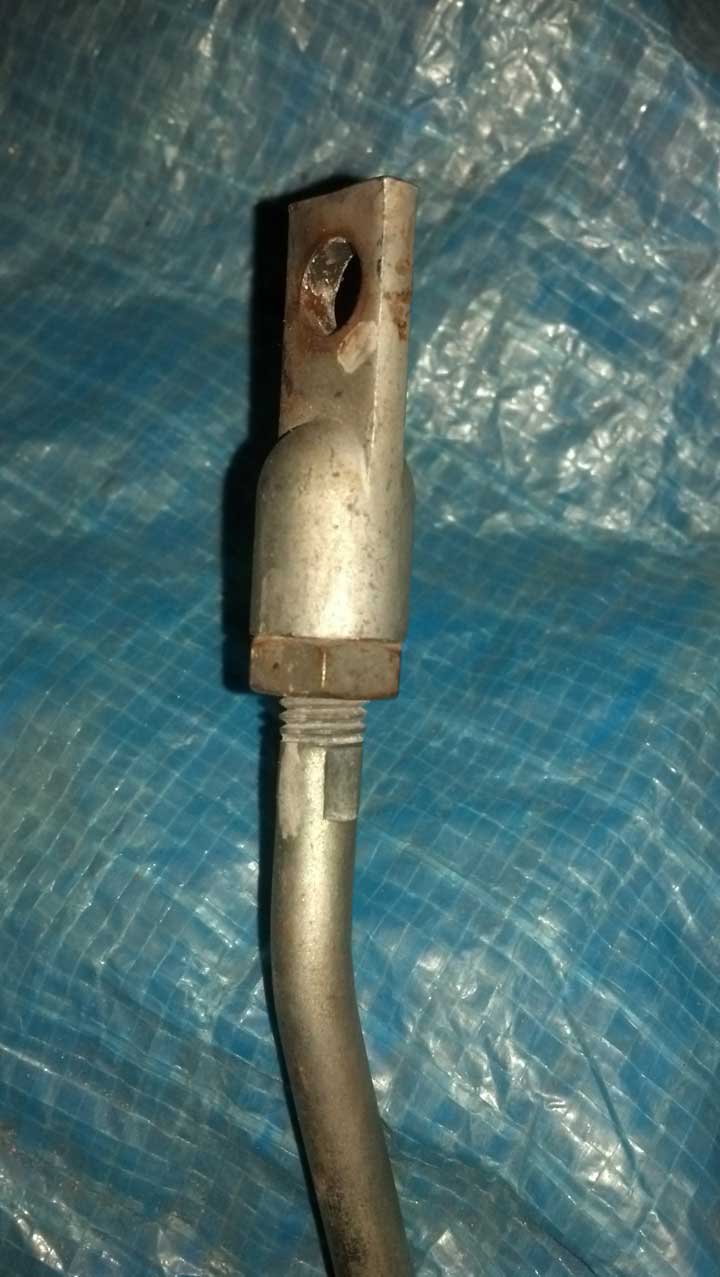

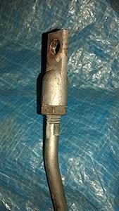

Looking at your video again I don't see any threads showing on the rod below the locking nut. Either the bends in rod got straightened out making it longer or the actuator isn't mounted right. With the right preload you need to pull the actuator rod with a channel locks or use a little compressed air to get the rod back on the arm.
Attached Thumbnails Is this normal?-slc_evo69-rod.jpg   Is this normal?-my-rod.jpg
