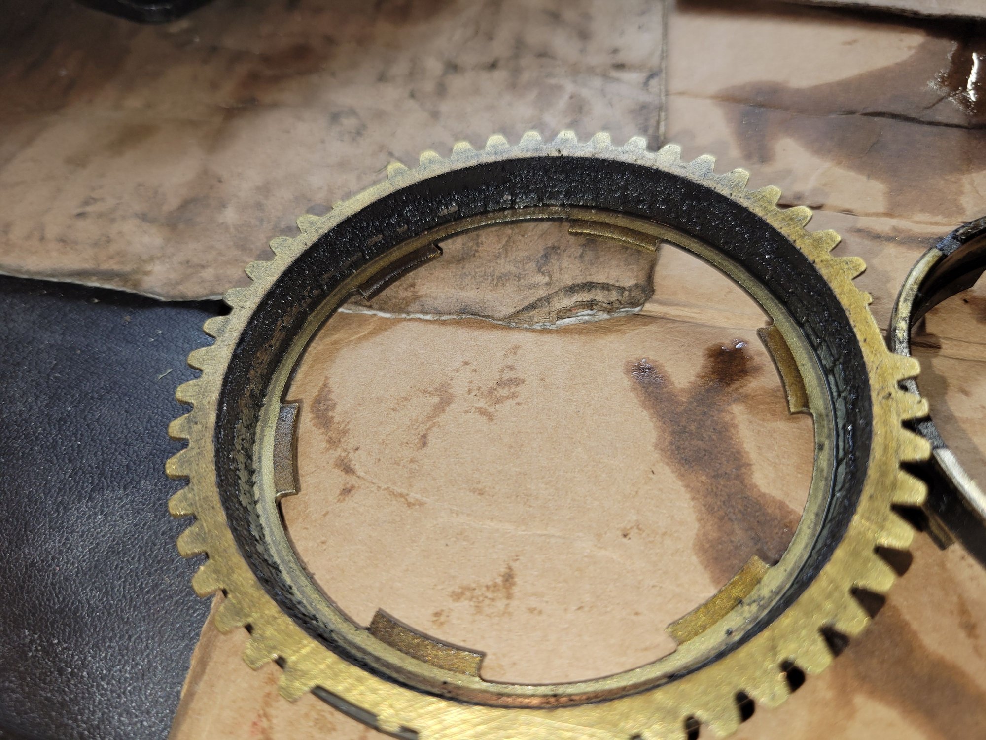

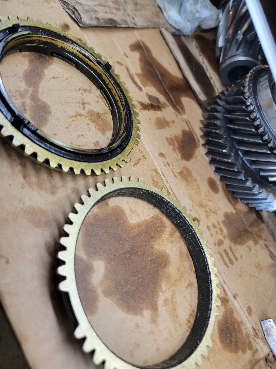

I have ran SyncroTech Carbon synchros for the last 6 years with ZERO issues. I've even left some pretty detailed reviews in this thread to help others. I installed brand new 2/3/4 synchros and springs with new 3/4 slider a few weeks back and finally got the car together last week. Mainly did it out of routine maintenance because of the cars power/usage but with the around 10k miles of use it wasn't completely necessary.
25 miles into my break in driving, 3rd clunks into gear, hard. Which to me meant the synchro wasn't slowing the gear to match with itself. Tore it down last night and sure enough, the Carbon literally disintegrated off the synchro and was just free spinning on the gear. I used RedLine MT85, warmed car up for 10 minutes before even moving the shifter and never went above 3k RPM because I know how important a gentle, shift heavy break in is for these kind of parts. Synchros were also coated in oil before installation so they were never dry. Here's a picture of the 4th synchro which looks brand new (because it is). Didn't check 2nd yet but I can say, I am super disappointed. I missed a Dyno Appt at STM, and also the first No Prep race of the year, $100 in drivetrain fluids etc etc. I sent an email in last week when I had the issue and the rep @Synchrotech has been easy to deal with thus far, he was just waiting on disassembly to verify the issue.
I will also say, when that Carbon comes apart it gets EVERYWHERE. My brand new trans fluid looks like 10k mile conventional motor oil. I am going to have to completely disassemble and throughly clean everything, again which is also upsetting. I sent pics in with some detail around the issue last night and I don't suspect they'll give me a hard time. I'd like to think this is just one of those times where this can happen randomly but I am seriously reconsidering using OEM synchros after this, even after years of success this was enough to change my perception.
