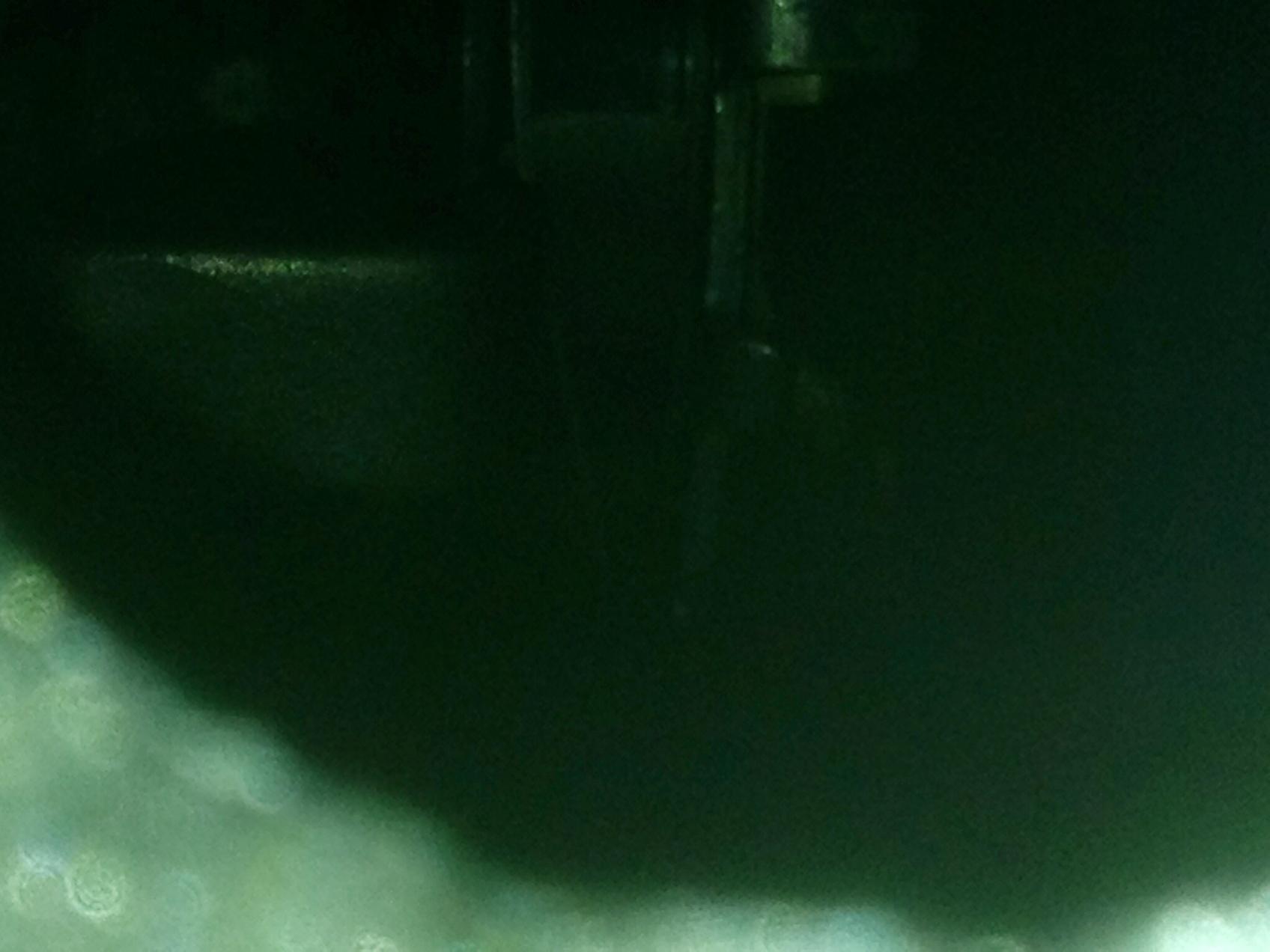

This is pretty tricky to do but first pick is no clutch pedal pushed

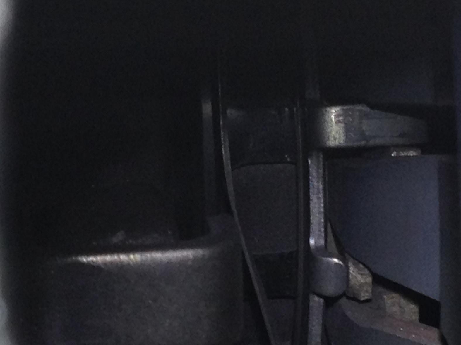

Second is clutch pedal down, kinda a crappy pic but the mono lock is at the end of the shaft on the tob about a mm or so off the body that attaches to the clutch fork

thanks for the pics, the thing that kinda confuses me is the amount of movement the TOb comes out of the lock ring before pulling the pressure plate. on mine it seems to be more than normal. im gonna give it another try tomorrow n if i dont like it/trust it im gonna order a new TOb. this will be my 4th time pulling and installing the trans lol im getting pretty damn good at it

Haha I hear you, I've done it 6 Times now, trying new clutches and replacing the trans. I just drop the subframe now, way easier. And yeah Mine is only moving like a mm or so out of the ring if that, if you've got like a qtr inch or something like that I'd just replace it rather than getting stranded on the side of the road with it popped out. Good luck.
