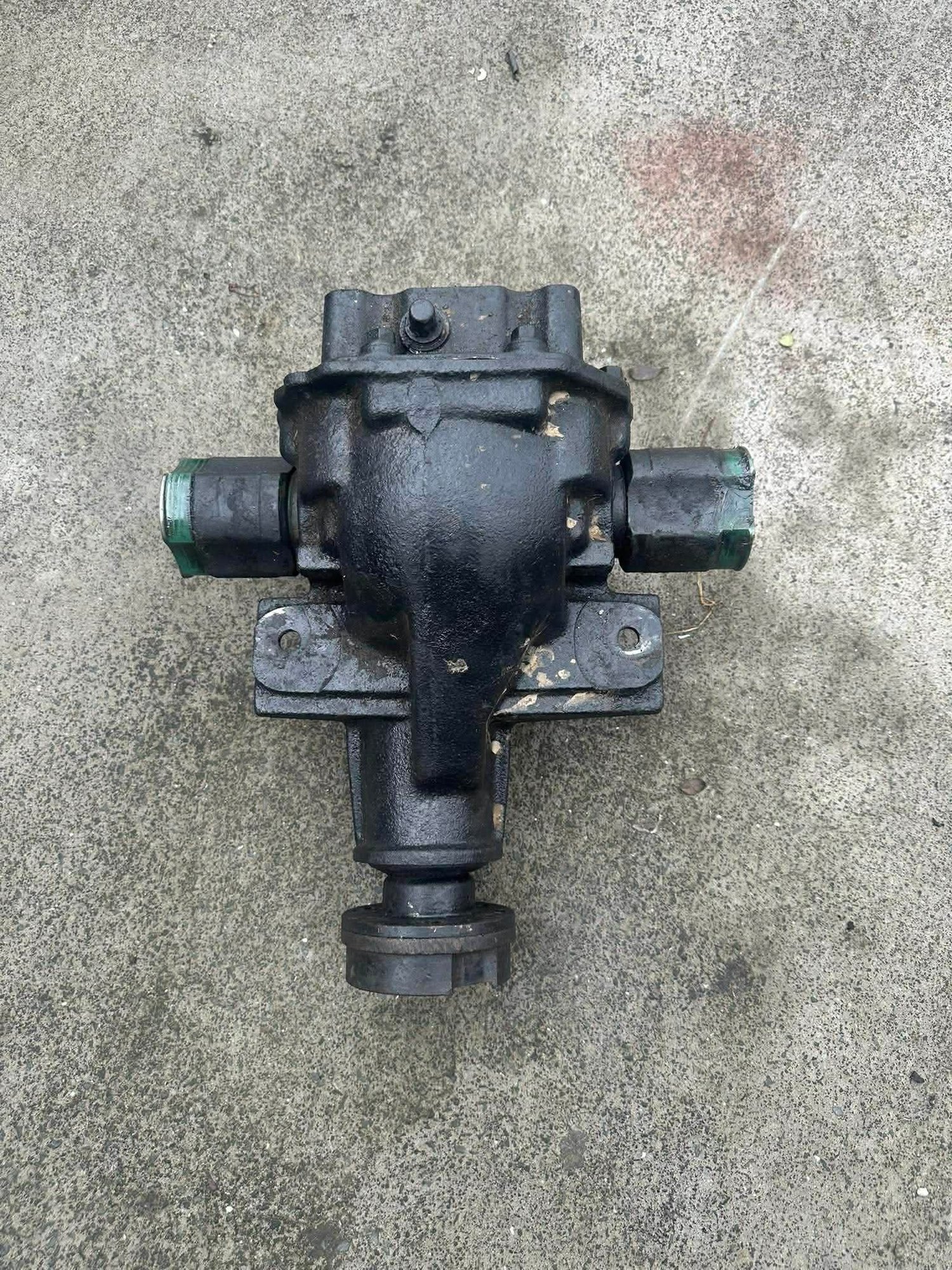

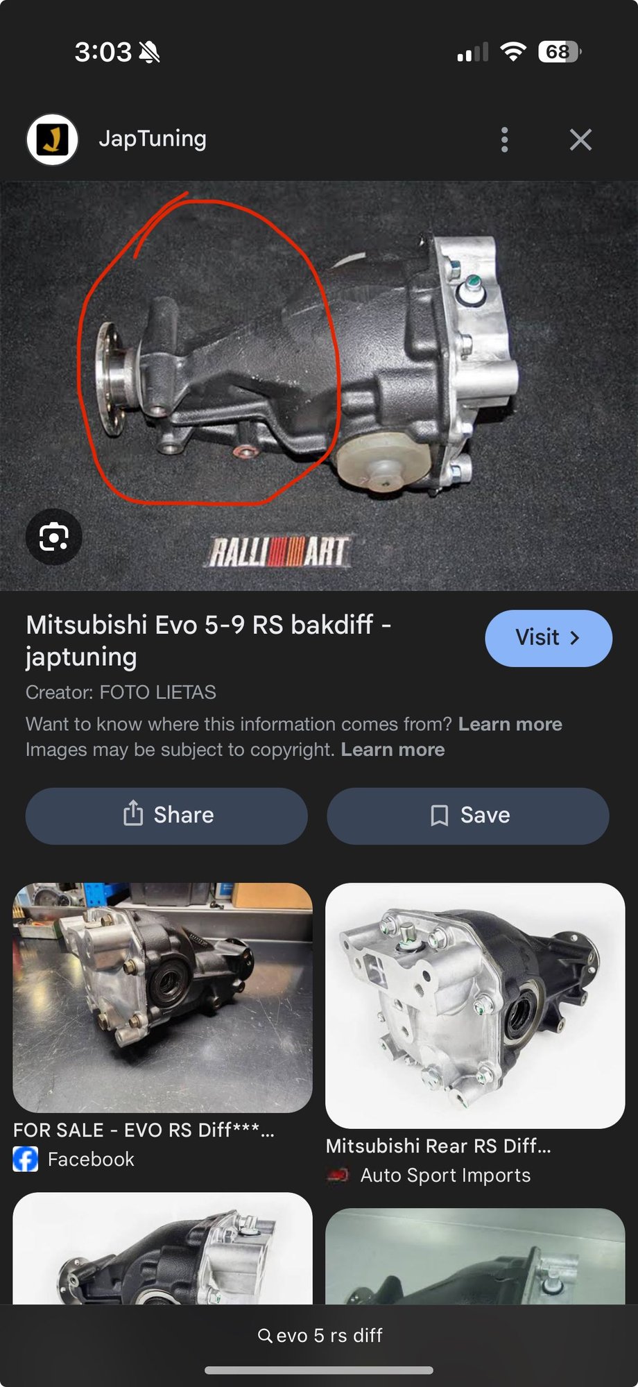

I’m looking to buy this diff out of a CM5A 1.8 GSR manual, my Evo 5 GSR still has AYC. After doing some research, people say this style diff is the same as Evo 1-4 and Evo 5-9 mounting points are different. Can someone confirm it’ll fit a Evo 5 too?
