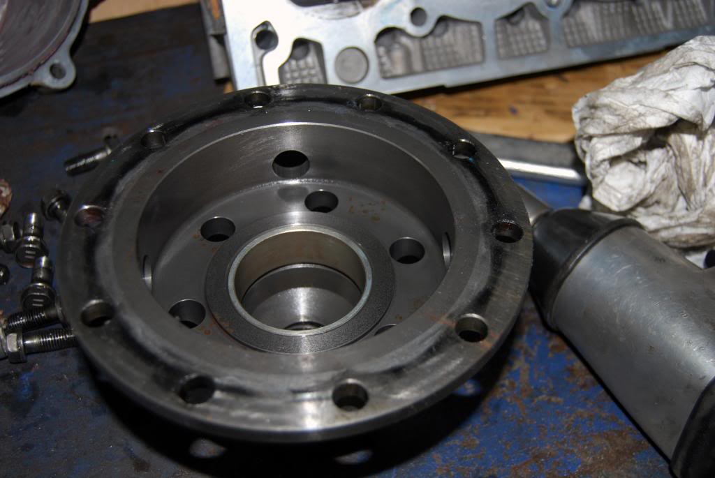

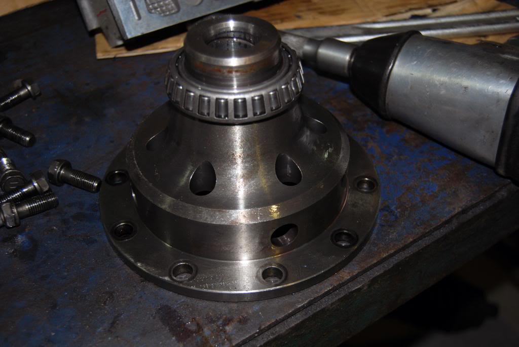

So its basically this housing. This is what I need, out of an E8 Non ACD Transfer Case.

Ah.
Any part that lives inside the transfer case is hard to get part numbers for, they are out there but they won't show up in CAPS/ASA because as far as Mitsubishi are concerned they want to sell the whole assembly.
However I'm running a Cusco front LSD and the only part that is reused from the factory setup is the ring gear as it comes with new cases. It included a new VCU.
