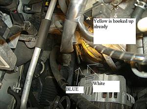

so i was checkin this out after searching! (throwing an EGR code)and of course i have the blue and white lines HANGING behind the intake manifold..... The nipples both broke off... This is why my car stumbles, then randomly runs like crap... would also explain the sudden boost like leak..... heres the picture... what do i have to do to get this working again? I DO NOT want to by pass it...
If i have to buy the new part, being the nipples cracked off, anyone got a part number or website i can order this off of...

well i ended uphaving to buy the part directly from mitsubishi.... Why on gods hell would they use a plastic nipple... Dumbasses Anyway, itll be here on monday, thanks for this thread guys...!!!
