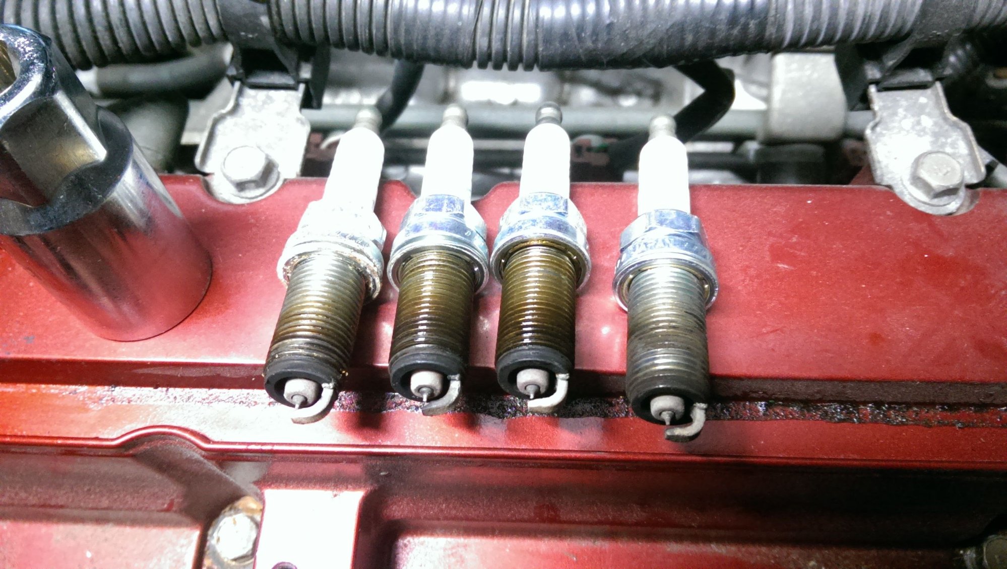

I got a proper blade tool with a end for opening and closing the gap. Worked like a charm, I think. Put in the new plugs and I still have a nasty backfire.
Here are the old plugs...
Placed in the order of the cylinders. <br/>
So the air coming out of the oil fill cap is normal? No worries there?
And I guess I'm on to the wires and coils. Is this the time to consider an upgrade? OEM a better idea? I don't want to need a retune.

Going to be a high of 64 today so I will change my plugs and report back. I have them gapped at .020 so we'll see if that helps. I'm using ngk bpr7es. If that doesn't correct the issue I will try the br7es as I think they are half a step colder. I may try the bpr8es before I consider a coil on plug setup.

PROBLEM SOLVED. Pulled the old plugs and looks like the shop that installed them used the BKR7E which seemed to be recommended for a subaru. I installed BPR7ES gapped at .020 and did a pull in 3rd gear and it revved smooth to redline.
