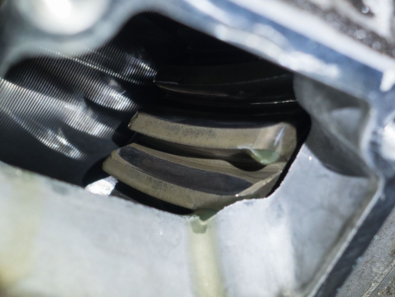

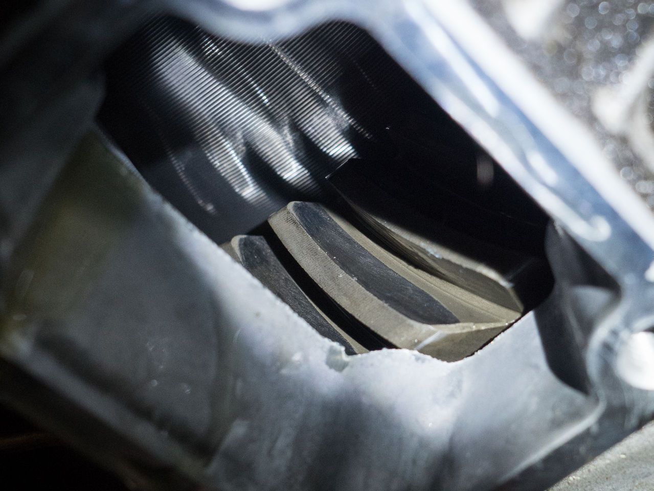

R&P wear cant always be seen. Often felt, or diagnosed with marking compound. Uploading high res pictures wont help much. I would def. gotten the transfer checked, and if possible and necessary reshimmed. If the wear is to much, the you would need a new set of ring and pinion.. Ah, the beautiful life of a Evo ownership

I know pics aren't the best way guys, but I need to try to get a consensus before i rip apart my daily and spend more money...just spent 3k on a tranny rebuild.

The pattern looks off. Did you ever get this resolved?
No, other projects taking priority.
Simply driving the car daily and living with it.
Thank you for analysis, can you describe what the pattern should look like?

It should go straight across the tooth. you can see that its an angle because of the gap on the toe off the tooth, but at the heel, the wear pattern is right on, or maybe even off the edge of, the tooth..

If anyone coming along this tread
If your Gears looking like the Pictures posted above you can say its GOOD...
Since we do a lot of Repairs on the Tcase here in Germany, that Load Pattern is the best you can expect after changing the ring and pinion, since the Adjuster Shim for the Tcase Nose is not available in perfect sizes. ( Adjusts the depth of the Pinion )
A Tcase looking like the pictures will not do any noise, nor will be an failure.
We had NEVER have an defect on any Transfercase due to Power or Driving / Wear.
Also never had Bearing fails...
All Whining Tcases had failed due to:
Not enough Oil inside ( if less than 400ml, it Fails. 600 - 650 Milliliter is perfect )
or
False OIL ( GL4 oils instead the recommended GL5 EP )
Steffen
or
Steffen
Still haven't addressed this but this makes me wonder if rear diff noise could sound like it's coming from the tcase/tyranny area?
Have oem fluid in the rear, any thicker fluid I can put in?
