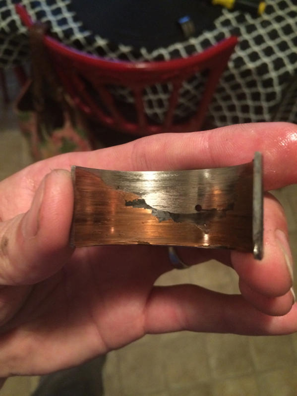

Pulled cylinder 4, this is what I have
Attached Thumbnails Play in piston/rod...-image-2447899190.jpg   Play in piston/rod...-image-2328024040.jpg   Play in piston/rod...-image-3345189918.jpg   Play in piston/rod...-image-3647288372.jpg   Play in piston/rod...-image-2280196959.jpg
Old May 17, 2015 | 07:48 PM
WikdEvo's Avatar
Joined: Sep 2012
Posts: 604
From: Des Moines, IA
Yep, that's what i'd expect it to look like.. Looks like time for a full rebuild.
Old May 17, 2015 | 07:52 PM
black_beauty's Avatar
Joined: Feb 2010
Posts: 854
From: Clarksville, TN
there was nothing in the oil or in the bottom of the pan when I pulled it? So should I change all 4 rod bearings? The other 3 cylinders didn't wiggle nearly the amount that cylinder 4 did
Old May 17, 2015 | 08:14 PM
xRoguex's Avatar
Joined: Apr 2009
Posts: 1,666
Likes: 12
From: Pittsburgh, PA
Its the only way to be sure.
Could you just slap a new bearing in there.... Maybe...
