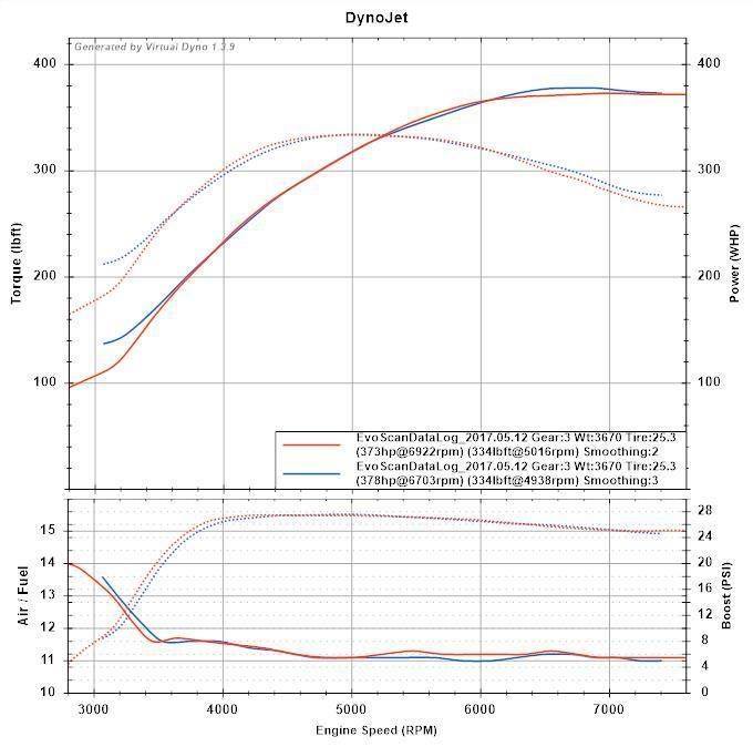

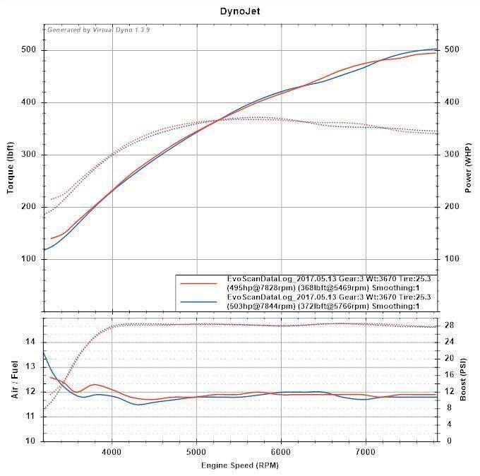

Originally Posted by xbattousai
Here is my results on 91/85 could've made 400 on but kept running into heat issues.
What are the rest of your mods?

I love it so far I do most street driving.
Mods are
Full Ets short route with tial bov
Ets Speed Density Intake
Ets 3.5 Intercooler
GSC S2 with Vavletrain
Arp Headstuds
FP Manifold
Map o2 housing
Spoolin COP
Grimmspeed EBCS
4bar Omni
