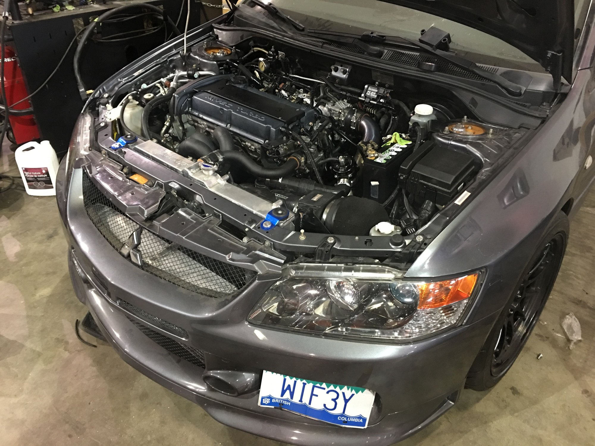

Quick Update. Shop started work on the motor yesterday. Turbo is back on and motor is going in:

Another quick update. Motor is in, just a few more loose ends to tie up and should be good to go for breakin and wastegate+pump tune (22psi+91 octane)
