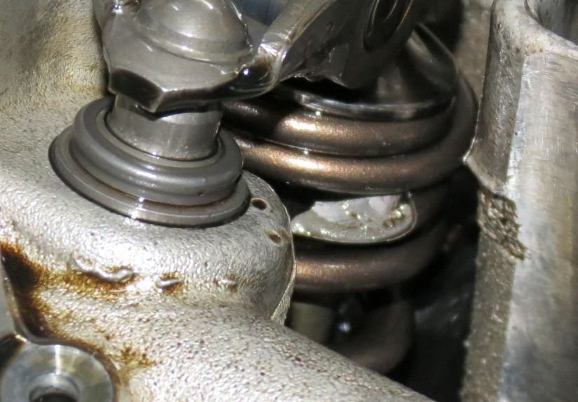

I would not recommend using GSC springs so go with Kiggley's. Many folks had springs break, taking out the motor. GSC would blame the customer stating it was installed incorrectly, which I suspect is complete garbage. I had one snap after a few thousand miles of driving. Called GSC and they were only willing to send me 1 new spring. Long story short, purchased a set of Kiggley's.
