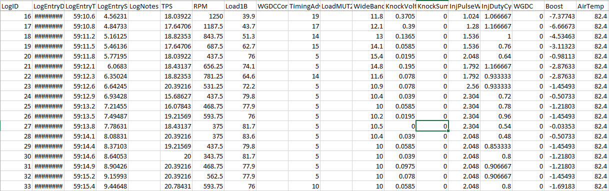

Here is a description of the problem:
The car was running fine without any issues what so ever, I swapped my in tank walbro 255, for a walbro 450. All is hardwired. I also have an external bosch 044.
After I installed the pump, did a few pulls and all was running well. I am running Speed Density. My car was tuned with a base fuel pressure of 58psi.
It ran very well throughout the winter season, now I start the car, try to drive it out, and as soon as I give it a little throttle and start depressing the clutch, it will go extremely rich and try to stall. If I give it more throttle, it will stay alive and buck hard because its too rich.
Please have a look at the log and you can see when the apply throttle while depressing the clutch, the car just dumps a lot of fuel and it stalls. Car revs just fine in neutral

I managed to get a good log when the issue is happening.

I was going through the logs, and noticed the timing is dipping to 5* where the car is attempting to stall. On my map, on that specific load & 500 rpm, timing is 11 degrees, although the car is going to 5* ... Is it normal or is my ECU going coucou
