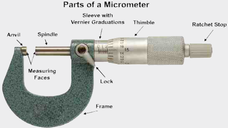

only to double check my measurements with my digital bore gauge, but the gauge is far more accurate.
this:
and this helps a lot.

Here is a Primer to help you with precision tool use.

I have the same brand Bore gauge as the guy in the video, but mine is digital, the Stretch gauge i got was the ARP one.

I use snap gauges, then measure them with a Mic, that way I only needed to buy one expensive tool.

using those tools in video would be nitemare for first time builder. I consider myself a well seasoned builder and dont use them. very difficult to get accurate readings. stay away.
use plastigauge for rod and mains. use six pieces per bearing.
use feeler gauge to measure piston to wall.
