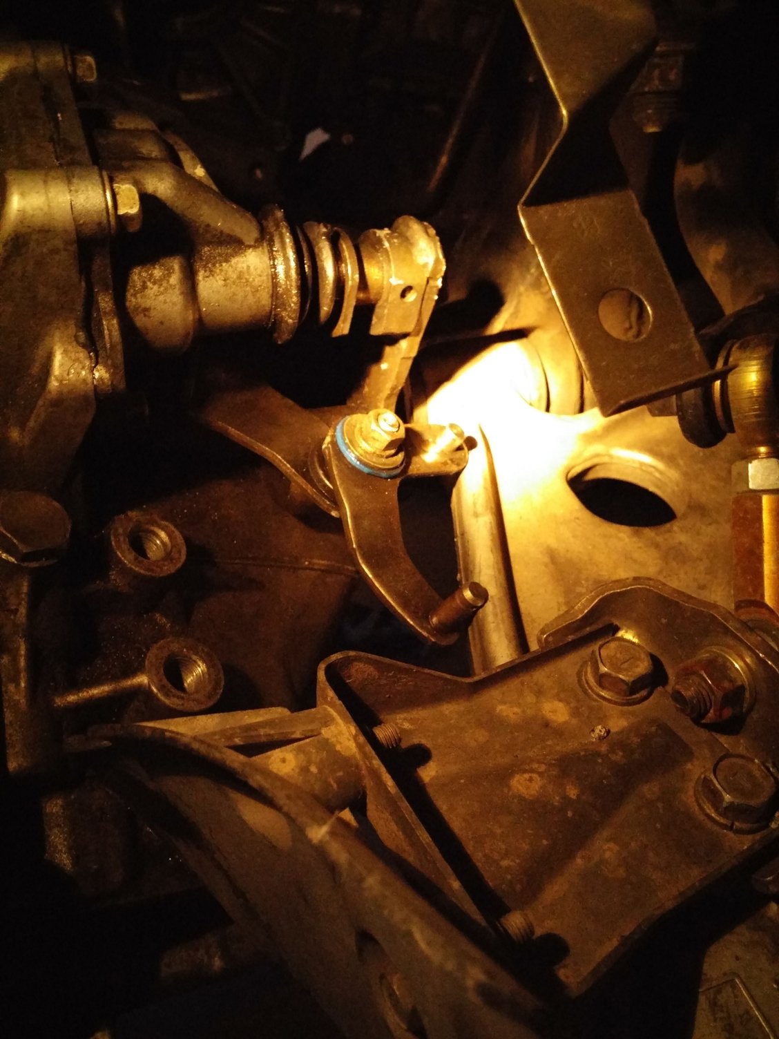

So, I bought a 5spd trans from a member here. Turns out it was stripped down before I got it, so I'm having to put it all back together. Yeah.. It's turning into a $1300 transmission.
Anyway, I'm missing a piece of the shifter assembly, but can't figure out what part. STM shows the two pieces I have, but that's it. Google turns up a bunch of pictures from angles where I can't see underneath. LOL.
Anyway, does anyone have a picture or, better yet, an extra one laying around? Cash in hand and will pay for overnight or 3-day.

Email the pic to TRE or shep. It looks like you're missing the part that pulls the main shift linkage up and down.
Yup. I'm guessing there is a part that mounts to the tab on one, and has some type of collar for the other, so the cable and move it up and down.
I'll be damned if i can't find a pic ANYWHERE. I emailed Shep, Jack's, and anyone else i could think of.. but forgot TRE. I'll email them now, thanks!

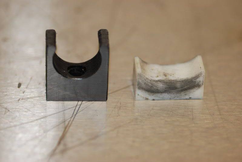

Maybe this piece, gear selector shaft bushing?
http://www.rosssport.com/Brands/ROSS...ed-RSTR410-GSB

Yea, that's it.

That's all I'm missing?? LOL
And it has a hole on in the bottom for the peg, I'm guessing?
I wonder if I can find one locally. Ordering from overseas will definitely keep me from making my next event.

That little bugger us $35!
If I had one to copy, I could make one for $5 LOL

http://www.streettunedmotorsports.co...e_md771824.htm
$7.50 and whatever delivery cost.
That black one from ross is upgrade, white is original
You rock, dude. Thanks. The guy I bought the trans from was kind enough to order two of the Ross pieces so he could send me one. But I am saving the link you posted. I looked all over STM's site LOL. It was on my phone, though.. sometimes I miss stuff. Thanks again.
I'm wondering how cheap Delrin stock is.
