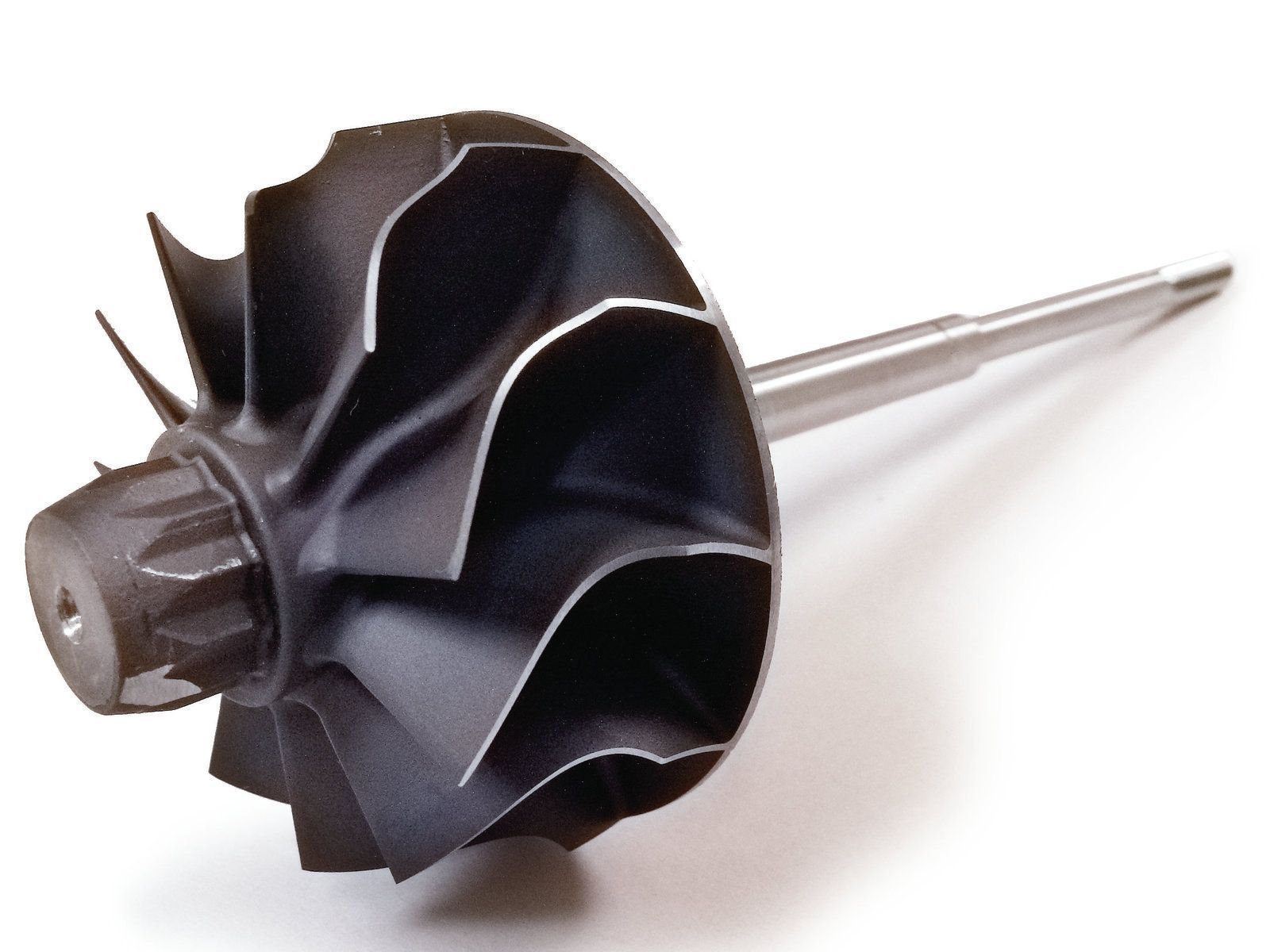

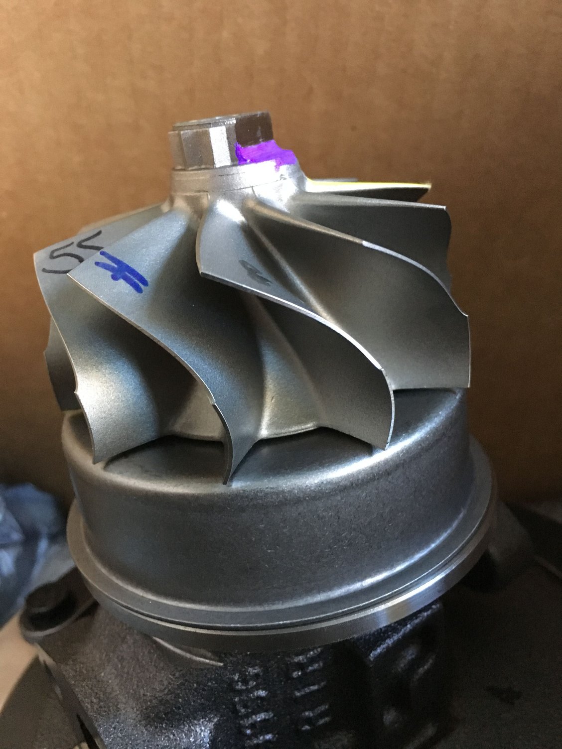

S369 turbine
EFR turbine
EFR turbine has a higher angle of incidence for faster spool.

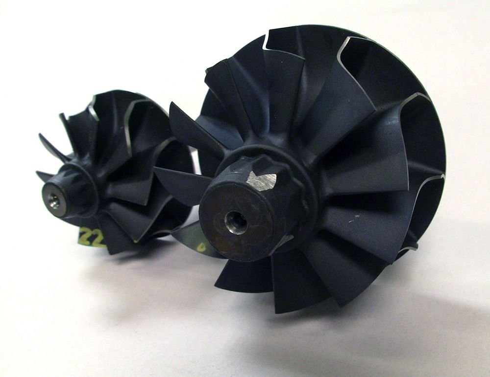

EFR turbo also has zero wheel clip, SX-E has 10* clip.
