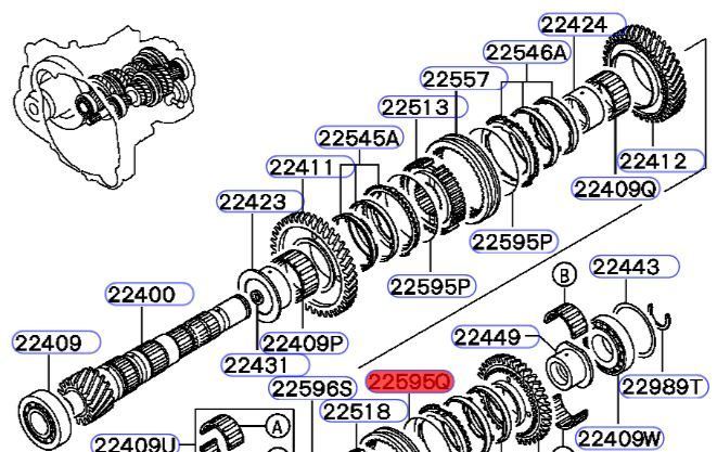

Want to do Evo 9 1st gear conversion anyone have the part numbers?
Old Oct 18, 2016 | 06:08 PM
evo8vz's Avatar
Joined: Oct 2015
Posts: 285
Likes: 12
From: Italy Venezia
Need the outputshaft and 1st gear
also 1st gear synchro help me
parts # thread is a cluster f*ck
Old Oct 18, 2016 | 07:21 PM
Make sure you double check this
Mitsubishi
MD771763
SHAFT,M/T OUTPUT (item 22400)
Mitsubishi
MR980814
GEAR,M/T OUTPUT SHAFT 1ST (item 22411)
Mitsubishi
MR581385
RING AS,M/T 1ST SPD SYNCH (Item 22454)
Old Oct 19, 2016 | 12:43 PM
LetsGetThisDone's Avatar
Joined: Oct 2013
Posts: 15,973
Likes: 1,629
You need the input shaft, not the output shaft.
Old Oct 21, 2016 | 09:09 PM
evo8vz's Avatar
Joined: Oct 2015
Posts: 285
Likes: 12
From: Italy Venezia
Mitsubishi
MD771763
Mitsubishi
MR980814
Mitsubishi
MR581385
do you have the input shaft part #
Old Oct 21, 2016 | 11:17 PM
evo8vz's Avatar
Joined: Oct 2015
Posts: 285
Likes: 12
From: Italy Venezia
http://www.awdmotorsports.com/Mitsub...p/mr980814.htm
lol im confused extremepsi gave me the same part #
but a bunch of sites say its for a 6 speed
Old Oct 21, 2016 | 11:53 PM
evo8vz's Avatar
Joined: Oct 2015
Posts: 285
Likes: 12
From: Italy Venezia
MN107627 input shaft ??? 5 speed
MR980814 1st gear ???? 5 speed
