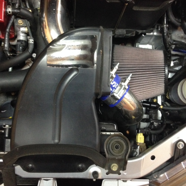

I run an converted ETS stainless MAF intake pipe with SD and recirculating stock Evo IX BOV. I have taken the MAF adaptor off and put a turbo velocity stack with the biggest K&N that would fit on it. Works well. No issues.
this is what i was thinking of doing, hoping that the Tial QR would fit nicely in place of my stock ix DV. any pics?

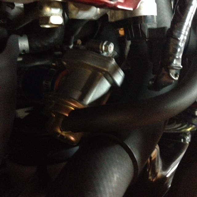

Here are some pics.
My cold air intake covers most of it ...
I extended the length of the ETS intake tube with 3" silicone hose to get the filter as far as possible to the driver's side to minimize hot air from the radiator.
Attached Thumbnails Recirc on Speed Density Setup?-img_2054.jpg   Recirc on Speed Density Setup?-img_2055.jpg   Recirc on Speed Density Setup?-img_2056.jpg
