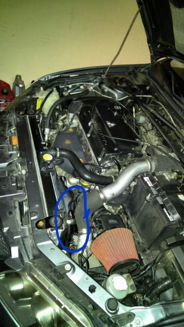

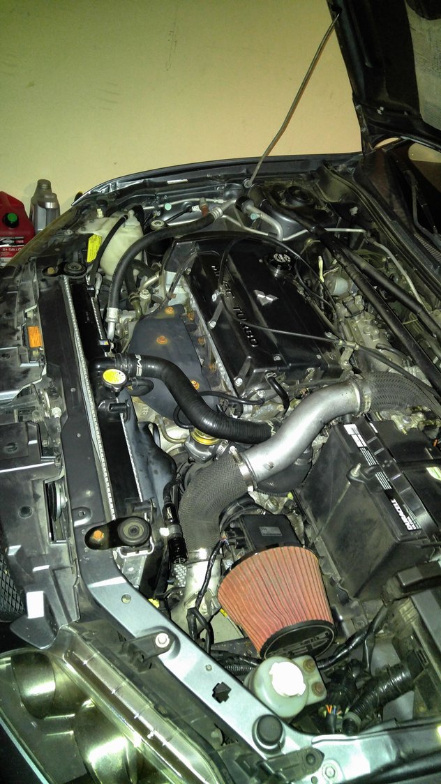

I don't have good lighting in my garage but here are some pics. If I have time I'll take some during day time.

It's been so long since my car was stock, but I think your DV is backwards. Was it positioned like this before you took off the intake hose?

What is this? Can you post close up pictures?

That is the HBC boost controller
Yeah that was the position. I hardly touched the motor till yesterday to look a compressor side of the turbo.
