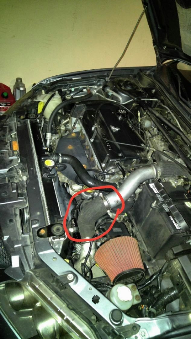

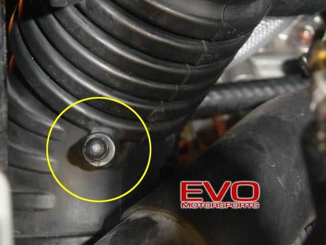

Here's another potential leak that can make your car run a bit leaner (not enough to cause your 20 reading by itself). Since you HBC only connects to J-pipe and WTA, check to make sure the factory turbo inlet hose nipple is plugged and isn't leaking air. It should be on bottom side under your hose next to your HBC.
Originally Posted by 2006EvoIXer
If your HBC is connected this way, it's fine. (One of your photos look like it was plumbed to the turbo intake hose).

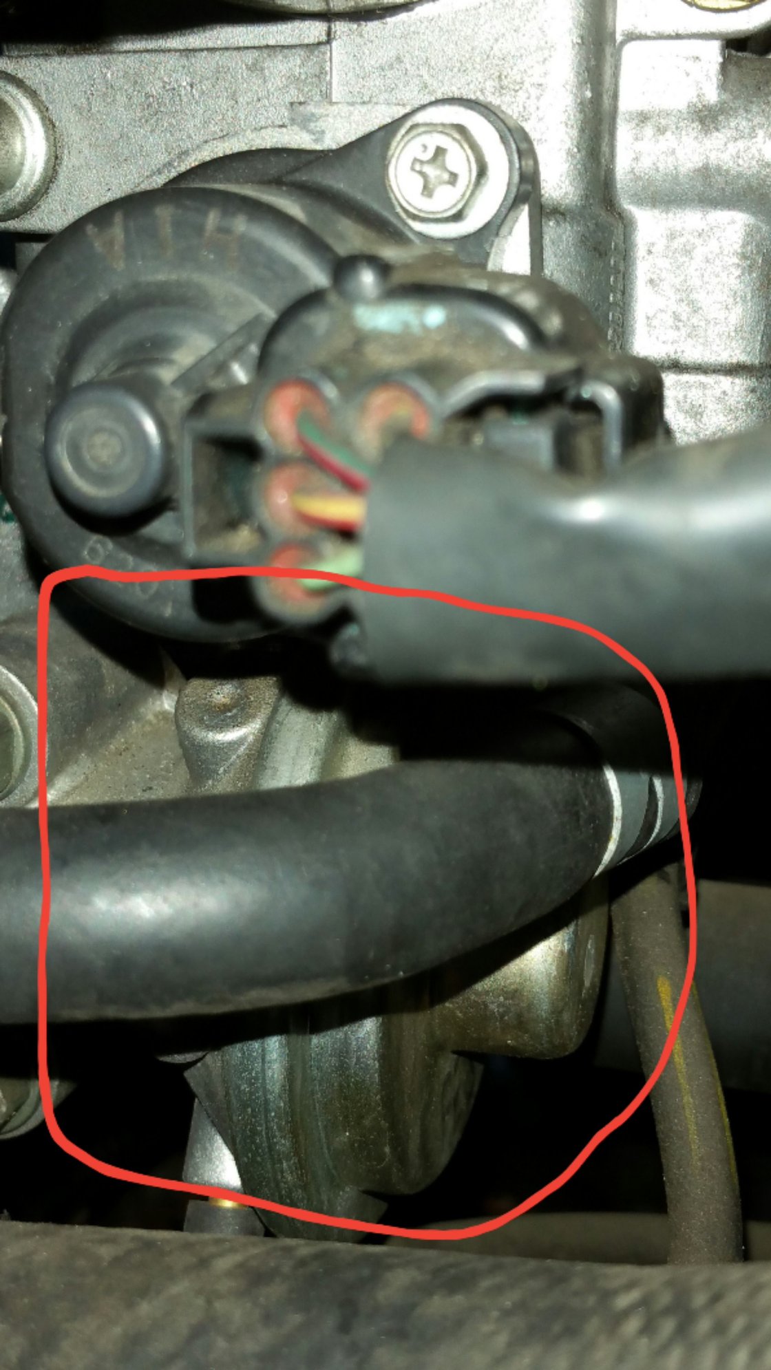

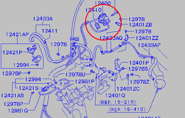

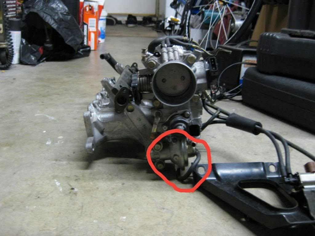

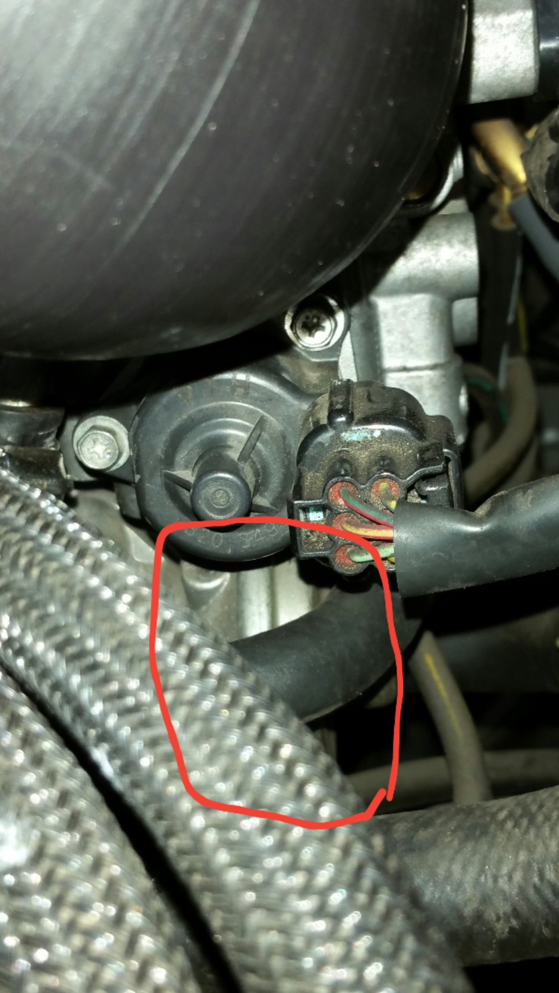

Take a look under your throttlebody. See if your EGR is still there. If it is, then the vacuum lines on top of your throttlebody should be reconnected.
Look for this:
