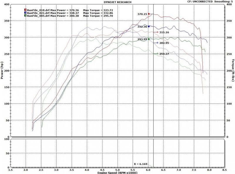

I searched for more info on differences and these are what i found. S2 has more lift, especially the exhaust side.
Stock vs S1 vs S2
Strange that S2 looks like it makes power faster than S1 as turbo is spooling up. Could be a glitch.

From the chart above, it looks like S1 makes about 20 whp more power 3600-4800 rpm. S2 makes about 30-38 whp more 5500+ rpms. I wonder if this is on stock 9 turbo.
