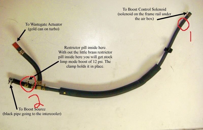

Hi. When putting my turbo back in I split one of the hoses that goes to the actuator. I think I broke the actual one that goes to the actuator, to be safe let's say I broke one of the 3 that connect via the t-piece. I replaced the little hose thinking nothing of it but now I'm peaking at 1.5bar when it used to peak nearer 1.9. I thought it was a boost leak as ive had a lot of boost pipes etc off but it's only just sprung to mind that there are some boost pills down there. Could I possibly have thrown away a boost pill which is why I'm losing boost? Like i said, I'm pretty sure it was the hose that goes to the actuator and on to the t-piece. I'll check tomorrow

One of our members post this pic that should help ID which line has the pill

Thanks for that. Pretty sure I binned the little one with the restrictor. Any way around it or should i just buy another? I've got an ebc and am setting up my wideband today, but as I'm a tuning noob I think changing boost control straight away might be a very steep learning curve

It's not required if you are running ebc. The stock setup relies on it.
