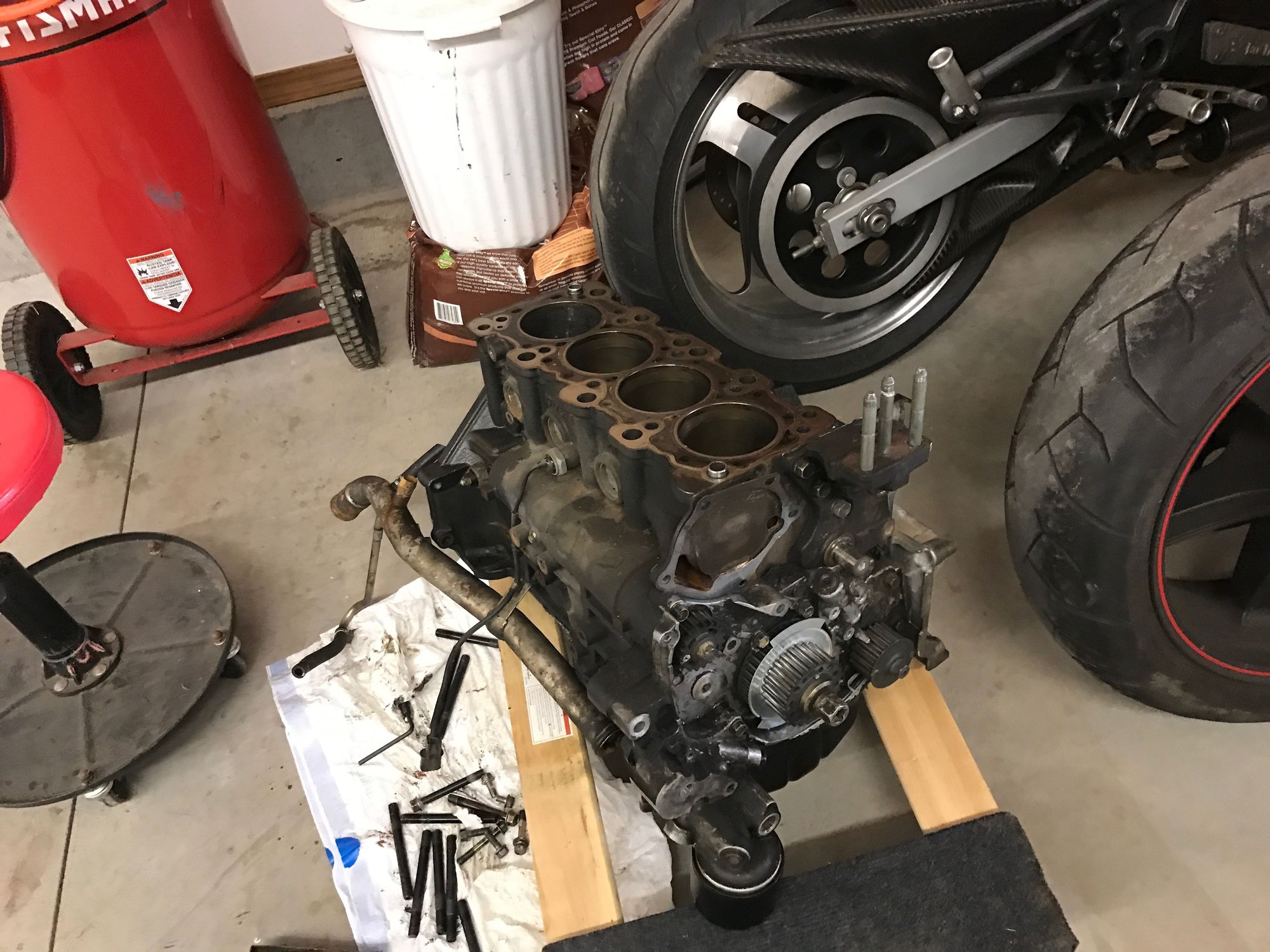

this is how the engines sitting, so should i take off the oil pan and undo the main caps on the crankshaft?
Buy and put it on engine stand.
This is safe and easy way.

i have the engine upside down with the oil pan off, the bolts are just extremely tight

Your likely using simple tools. You need a 1/2 ratchet about 2 foot long or a good 3/8 with a pipe extendo

The front case and rear main seal housing will need to come off first. Then you'll need a breaker bar (or ratchet with a pipe to extend the handle), to remove the main cap bolts.
