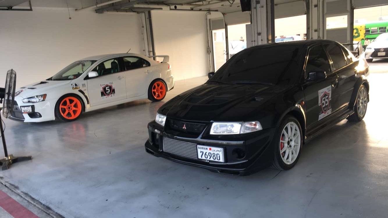

Thing is seeeexay!

Wholly ***** how do you see where your going with that crazy glass tint?
No worries
