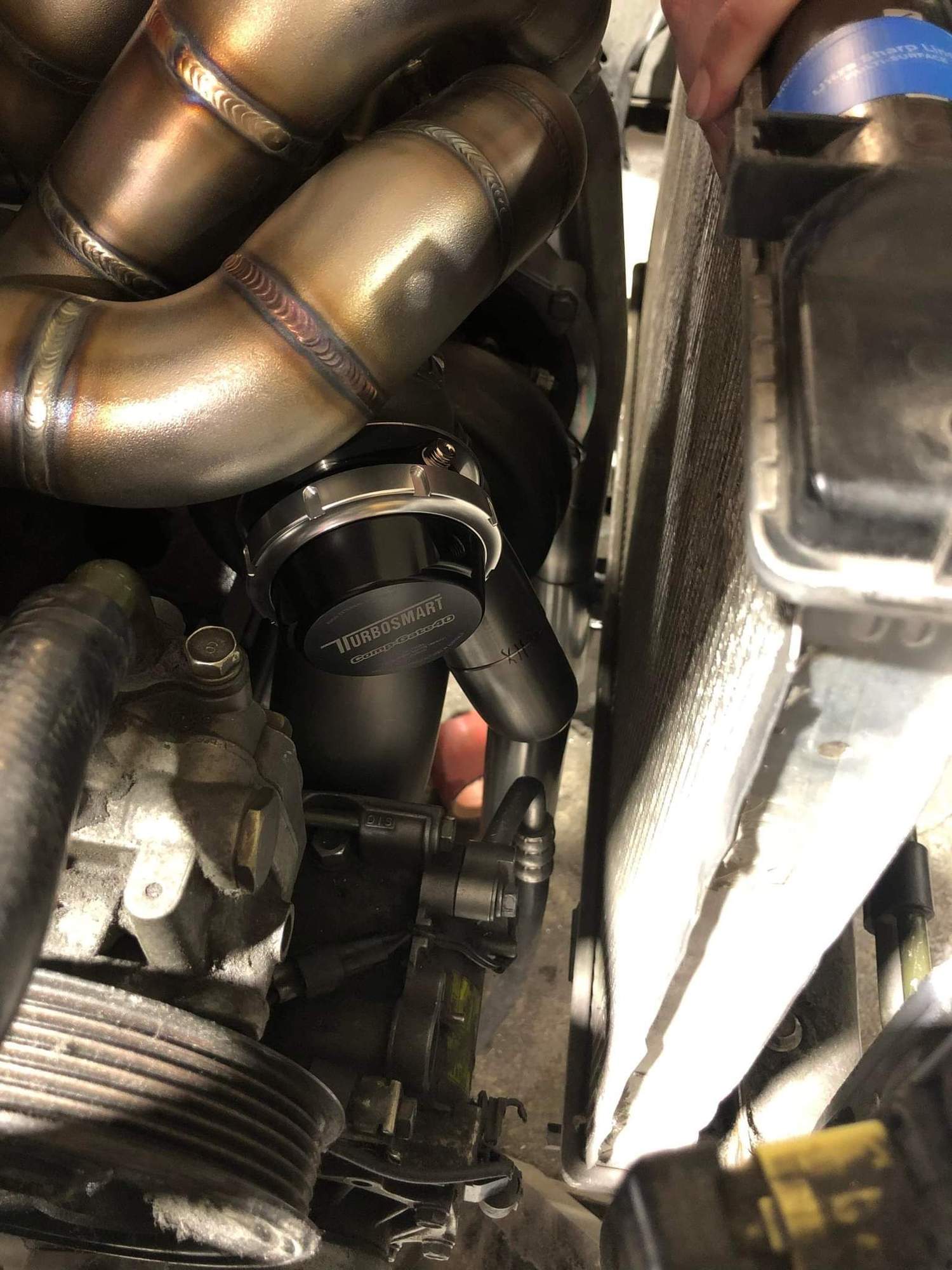

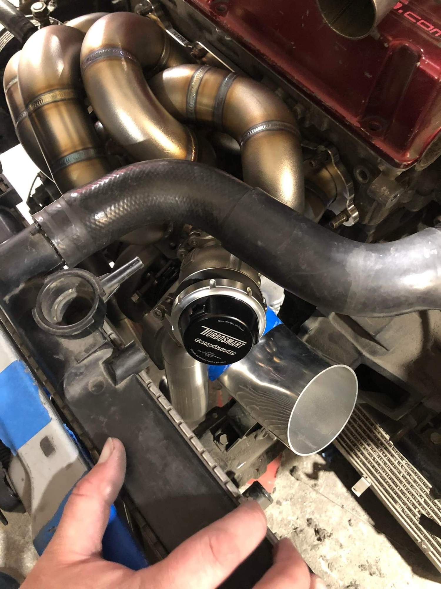

its my personal car and the lack of time may prevent me from upgrading to more then pumpgas this year. I will try!
the rest of the turbo kit should be finished next week. You can see it is not finished as far as welding goes. Also had to get creative routing the dumps.

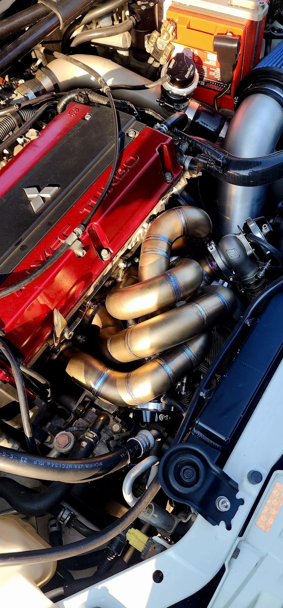

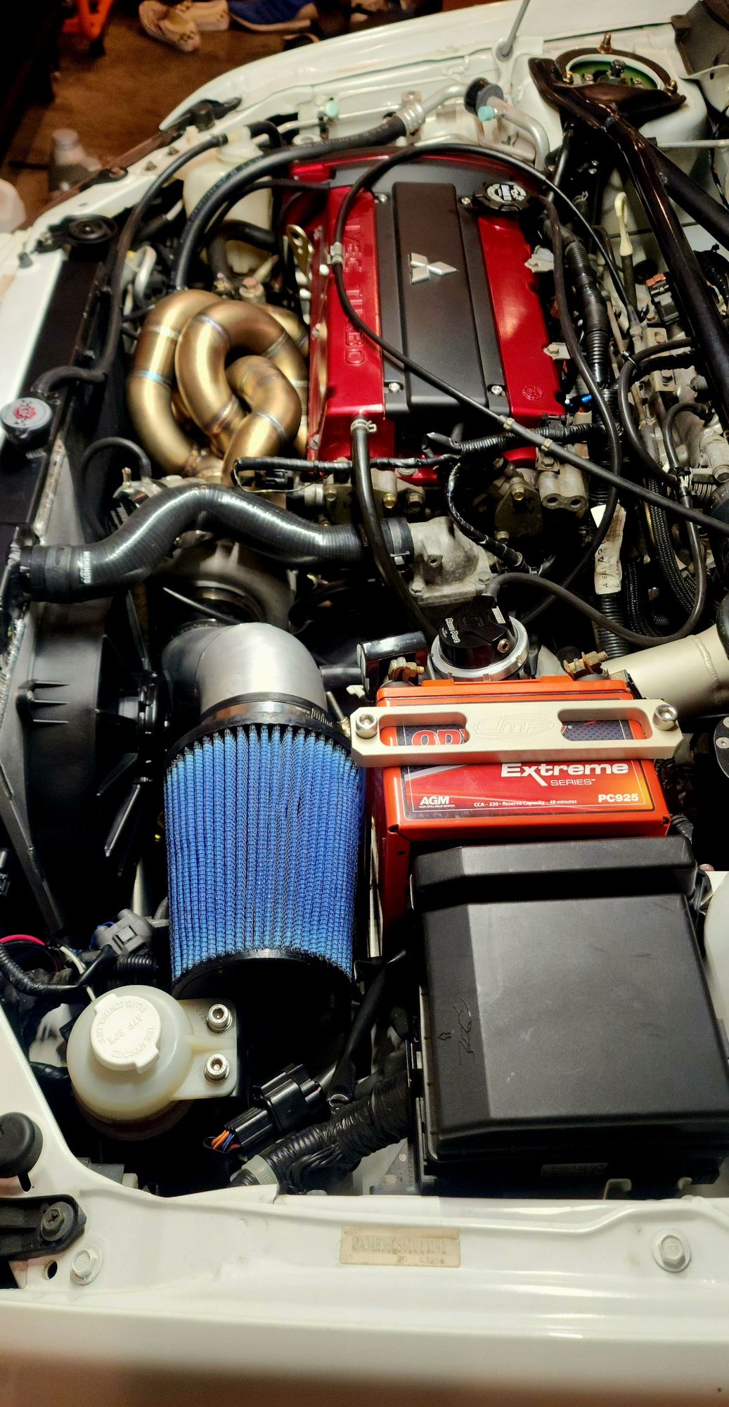

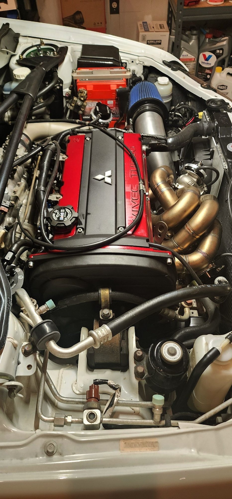

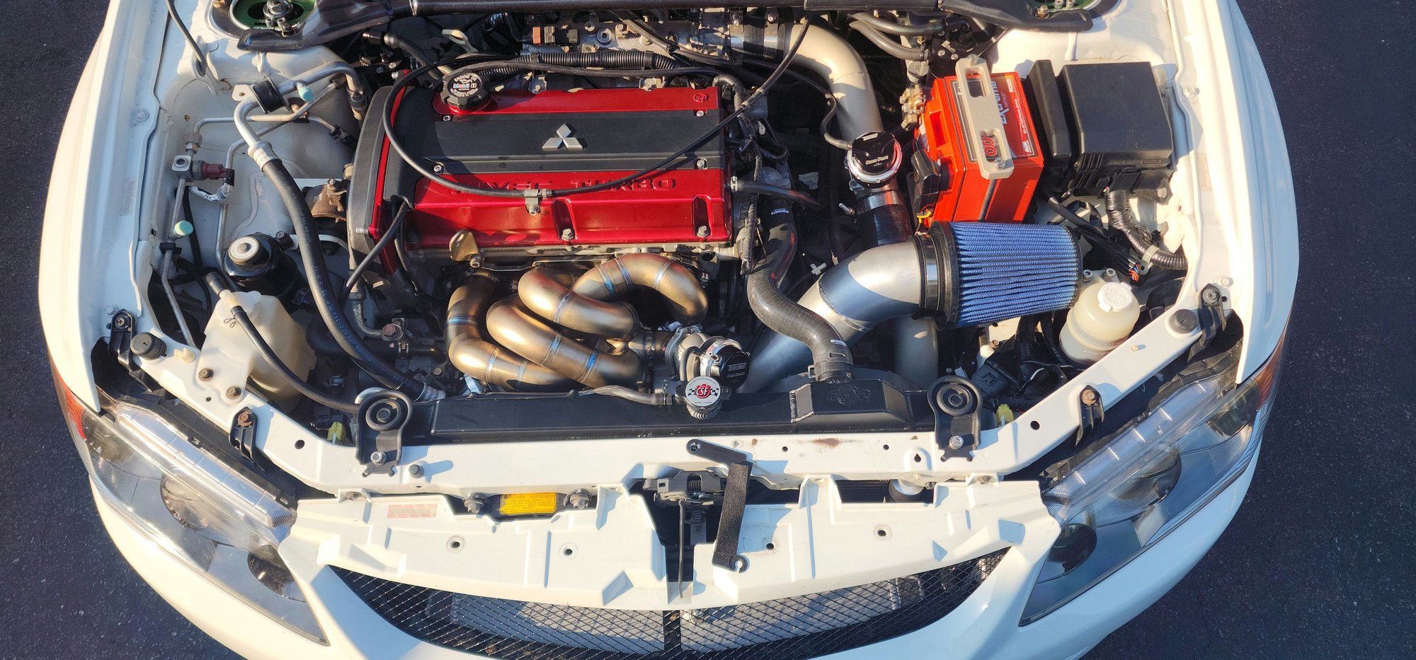

It took me two years (which is embarrassing) but I finally have the car together and road worthy (I do not have much time to commit to cars anymore). There were some extra wrinkles getting everything to fit with this kit while still keeping AC. For reference this is a T4 Garrett twin scroll bottom mount G35-900 standard rotation with wastegates dumping underneath. This setup is essentially 20lbs of crap in a 5lb bag as there is not much space to work with and every component seems to have minimal clearance (the wide turbine housing has alot to do with this as well). Initial impressions I have as far as spool response are very similar to FP Red powered cars. Should have some pump gas numbers soon.
