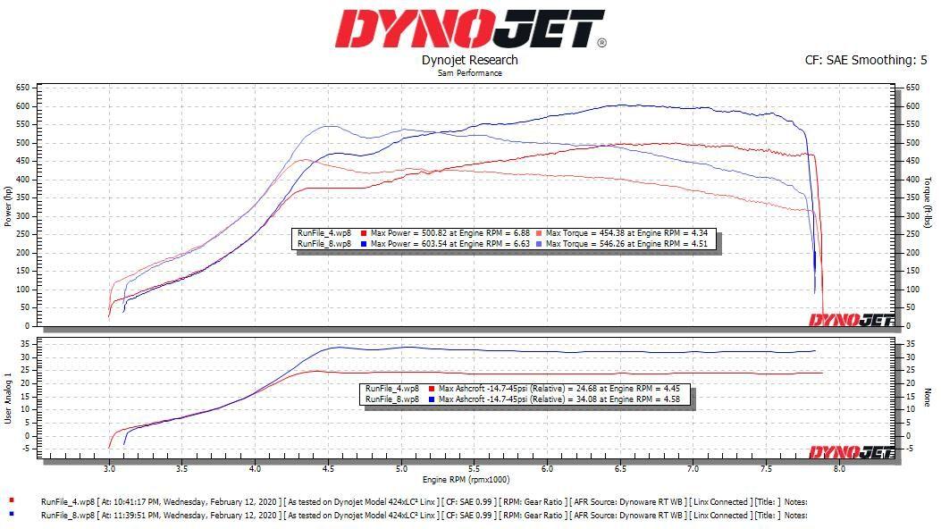

G35-900 Garrett Turbo on Subaru STi
Originally Posted by Zuhair Yahya
G30 770 0.82ar on sti ej257 with pump gas and meth
https://youtu.be/Gow1C-9pEX4
Dyno result:
  • 470 whp & 466 ft-lbs @24 psi Pump Gas /Meth
  • 565 whp & 570 ft-lbs @32 psi Pump Gas/Meth.
Here's a G35-900
Dyno results:
500 whp & 454 ft-lbs @ 24psi Pump Gas/Meth.
603 whp & 546 ft-lbs @ 32.5 psi Pump Gas/Meth.

This happens to be my ride. The highest octane pump gas available to us in the UAE is 98 RON (93 MON).
Also running an aquamist HFS-4 with 2 nozzles upstream of the throttle body (dont recall the injection rates).
According to the tuner (Sam Performance Dubai), with less restrictive headers, and an external wastegate dump, and race fuel, this setup is capable of 750 Whp

Nice! Yeah, a set of Killer B Motorsport Holy Headers and an external wastegate dump would definitely free up some power.
