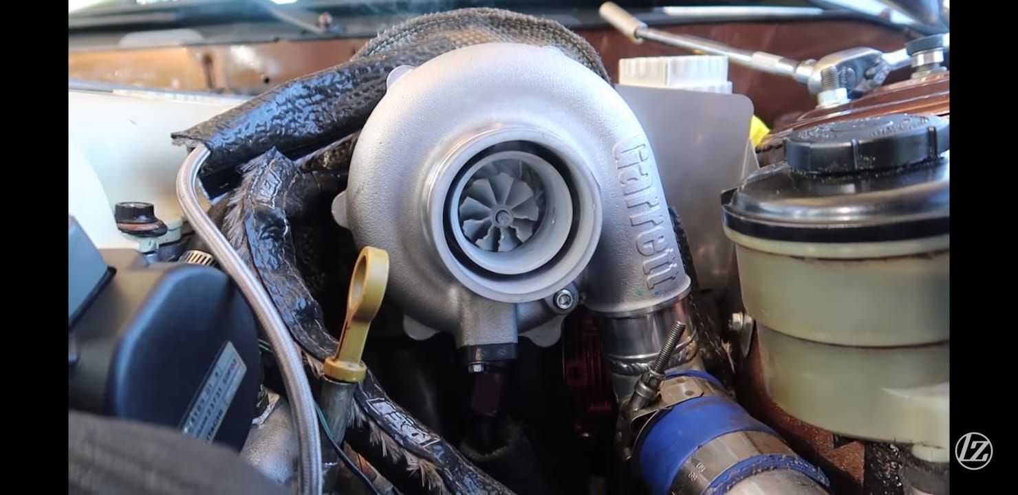

I know that the following video is not very interesting but, in any case here it is, a test with 22.5 psi on street pulling 2° and 3° gear:
Before to show the final dyno i need time since that the ecu tuning in made by myself. For any question, just ask
