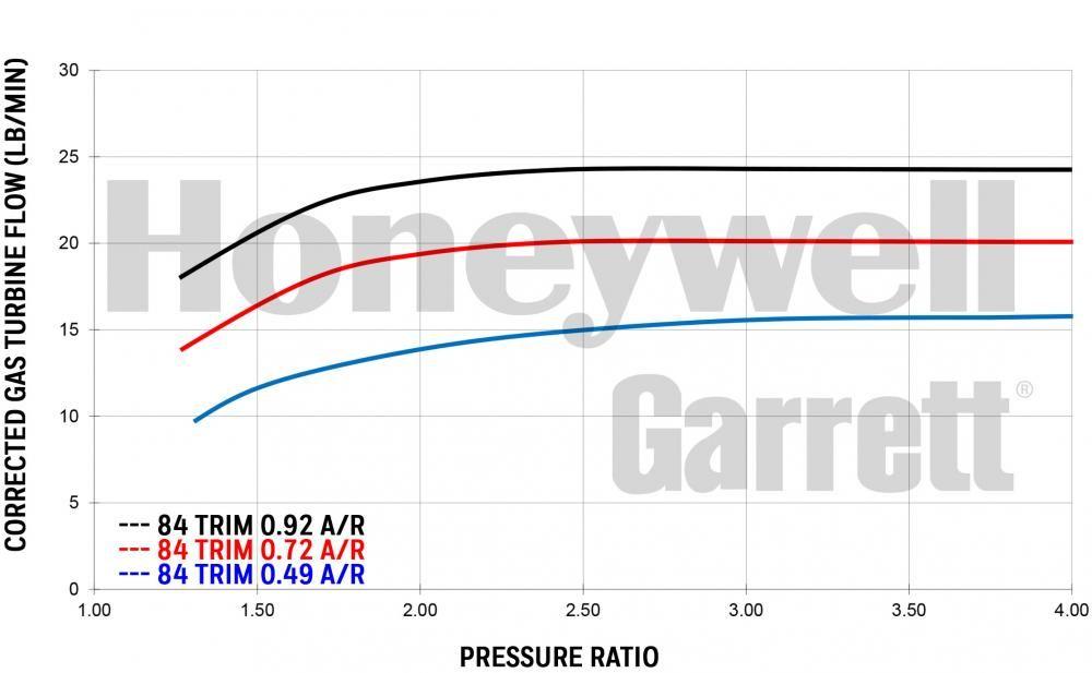

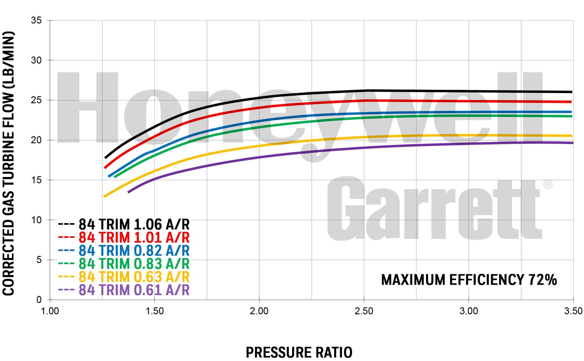

Originally Posted by spdracerut
I imagine the 0.72 would shift your boost curve 500rpm sooner. But like you said, your were targeting top-end power.
Yes, I think that the 0.72 can drastically improve the spool. The new exhaust housing and exhaust blade design allows to obtain an incredible exhaust flowing for the size. Here a comparison with the gtx3076.
G25-660:
GTX3076 gen 2:
Basically no one use the 1.01 AR in the gtx3076 because is not responsive, but on the g25-660, the 0.92 AR, which have a similar maximum exhaust flowing works great in the daily driving. For the same reason I can imagine that the G25-660 with 0.72 AR, which is comparable with the gtx3076 0.61/0.63 AR, would be ultra responsive on low rpm.
