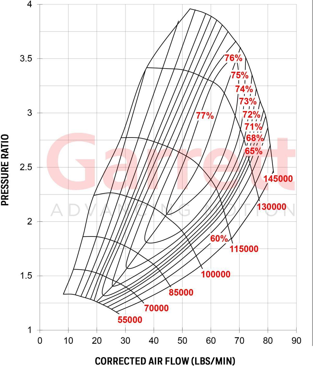

Compressor map for the G35-900:

Interesting they both flow less than their rated output..
I don't follow? The only way of knowing if they meet their flow ratings is by testing them?

The rule of thumb is 10 flywheel HP per lb/min of airflow.
Presumably the G35-900 is meant to be a 900hp turbo, which would require a map that extends to 90lb/min. Instead, it stops around 82lb/min.

The G35-900 comp wheel should be 76mm, so it's the GTX3576 replacement in wheel sizes with GTX3582R power. That G35-900 is going to be one bad mother. The top speed line of 145k rpms is the base indicator for the wheel diameter. The new G-series compressor wheel destroys the old GTX Gen2 wheel in flow with a bump in peak efficiency too.
The G30-770 should be a GTX3071R wheel size equivalent. That G35-1050 will be the GTX3582 replacement with 82mm comp wheel. The G35-900 will be snappier, but of course it won't make the power of the G35-1050.
Garrett did change how they 'rate' their compressor wheel hp range. But honestly, it's just making garbage. All that matters is the compressor map.

Well.... on E85, people seem to be eeking out 10whp per lb/min airflow on pure track setups. Tack on 15% for crank hp...... but like I said, it doesn't really matter what the marketing numbers say because it's all engine and fuel depending anyway. All that matters is the map.

That is a very out of date and very vague rule of thumb which very much doesn't apply to most setups these days.

^^^ THIS. It frustrates me that Garrett literally put a HP claim in the marketing, but frustrates me equally when people use some random internet rule to claim what it's actually capable of. The turbo's flow potential and the engine's ability to convert airflow into hp is what matters, and realistically depending on the setup - it would be possible to EXCEED 900hp @ crank with that turbo.
