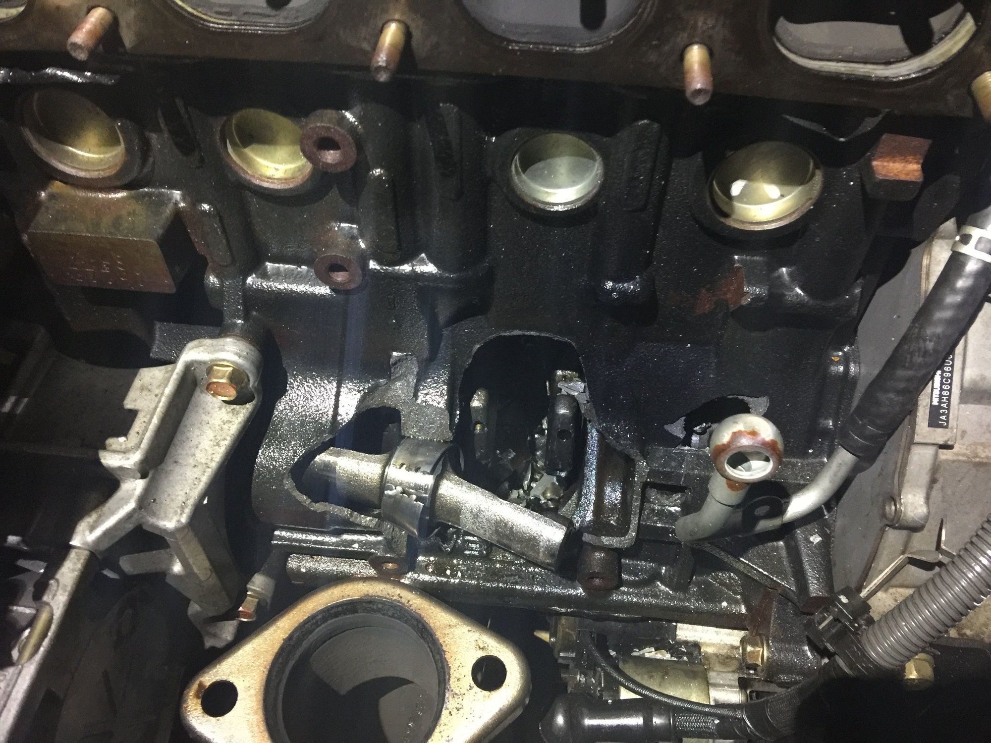

Long time lurker, I finally made an account.. and as I've seen, many blown 4g63s have popped up here. My block has finally blown, after 6 years.. but the 6 speed is still holding strong! Plans for the car are, and have been, auto x and some local tracks and I am really trying to exhaust my other options besides the '63.. The 4g69 is diiiirt cheap around me, and I know pretty much everything I need. I am going to go:
100mm crank
150mm rods
87mm pistons
(brands etc I'll figure out after I've hammered out the details)
Now, I am not someone who is 'seriously'into racing, it's all in fun and entertainment as this is my "fun car". I don't need 8k+ RPMs and just want something to spool my FP black up a bit faster for the street and won't hurt the wallet too badly.
I can't find much definitive or assuring information about the 4g63 intake/exhaust manifold mounting to the 4g69. Also any information on the evo IX 6 speed mounting up would be helpful. Or any help at all on making either work with the evo 9 MR platform...
If I have missed any forum posts, or simply looked over any important ones, please link me here if possible. (Also mods, I'm sorry if this is the wrong place to post this type of question. Any and all help is appreciated!
