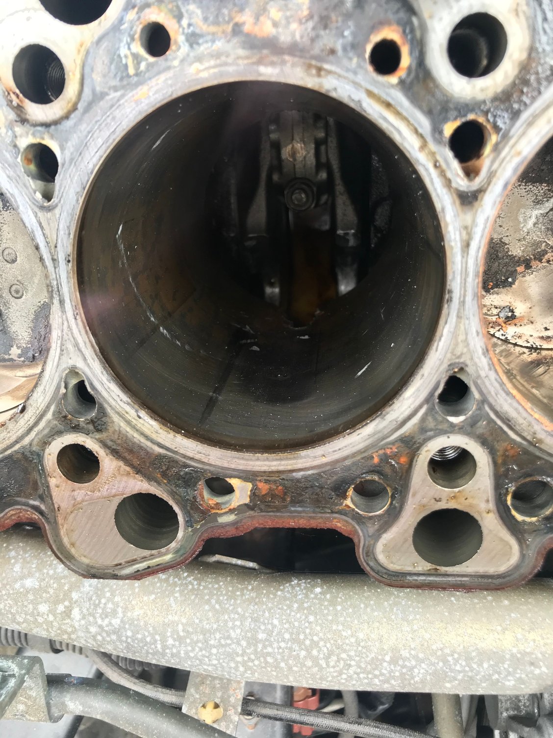

finally got around to pulling the head off yesterday with a friend here are some pics
the belt was frayed but not broken I cut it off

Head looks salvageable.
