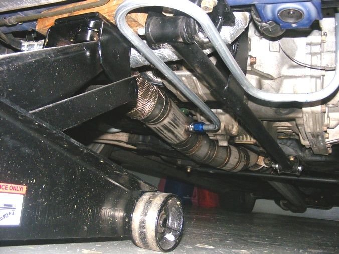

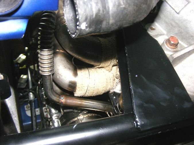

Gingeneering makes really nice mounts for the side, front and trans.I'm not a fan of any of the rear mounts on the market for various reasons, so I created my own rear mount. But, changing out anything beyond the front mount is going to add noticeable vibration in my experience.
That's a killer looking rear mount! How has it been working out for you? Yeah I think I'm leaning more towards a 70A front mount and just fresh new oem side mounts. It's not my DD but I'm super **** about rattles =\ and noises.

Hey Soso =)
Ive done the 3 mounts using the TS mounts. I did not do the rear trans mount as Ive heard its a real tooth rattler (haha). With my 3 hard mounts, it runs super tight & no harsh NVH
