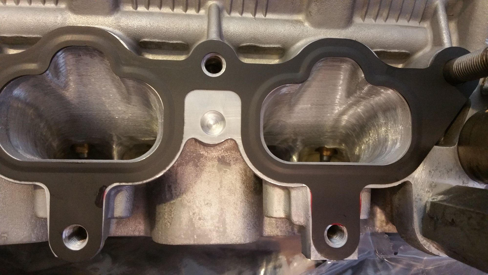

I actually noticed my gasket sagged in middle. So I turned head on side to bolt manifold on. I used a little preassembly lube to hold gasket in place as I tightened bolts from inside out.

And yes, sagging gasket does stick into the flow passage a tiny bit if not pushed up when bolting manifold on.
