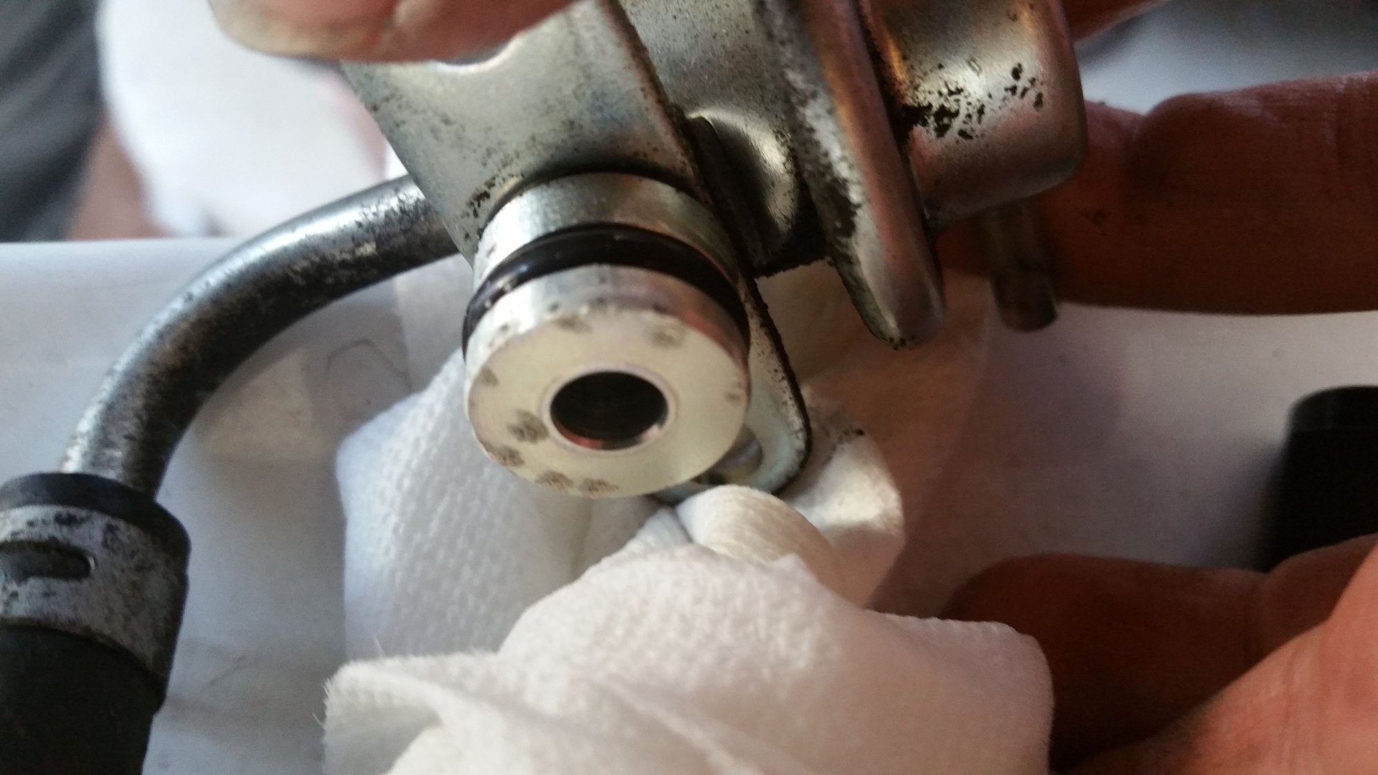

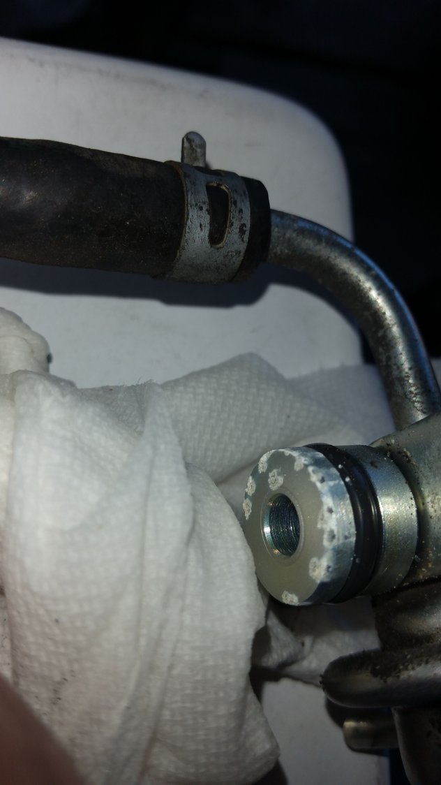

This is my connection between oem fuel rail and fpr where I let evaporate since I took off my injectors for cleaning and didn't install injectors until head was built. This is dried up and sat for 3 months. And yes, during these months, it rained a lot so moisture was plentiful.
Again, this is what I found on my car. Believe what you want and take your risks as informed as possible.

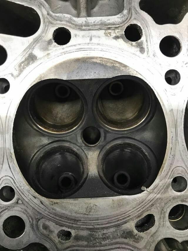

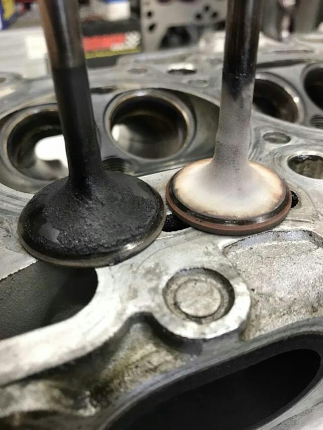

Here are pictures on my head before any work was done. 61k on it and 56k was on 91 while last 5k was on E85.
Old Jul 21, 2018 | 02:15 PM
2006EvoIXer's Avatar
Joined: Jul 2012
Posts: 3,294
Likes: 197
From: California
Valves look bad. Intake was full of build up and exhaust looks like it ran lean?
