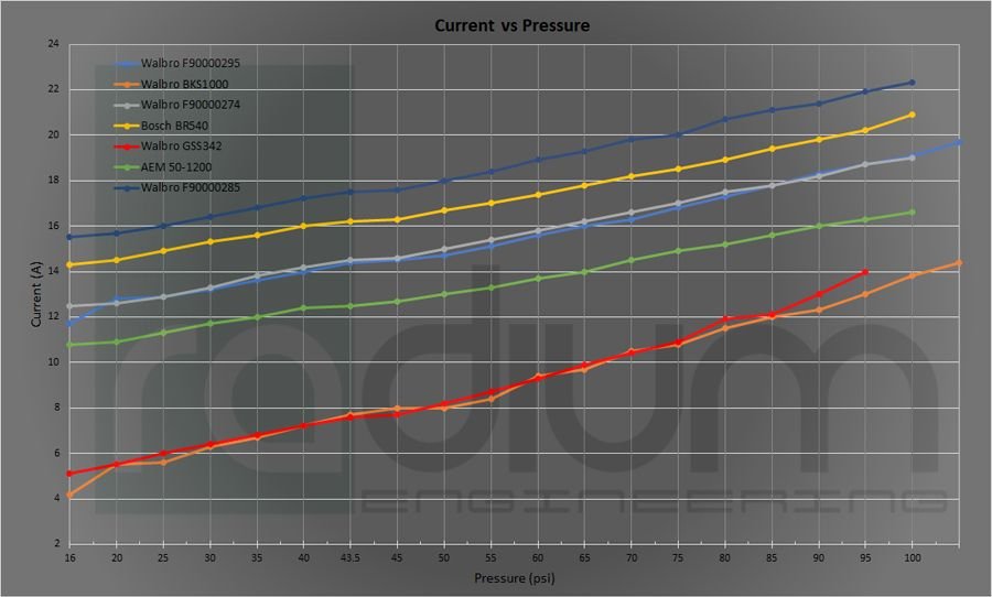

Here's a photo that I just took. F90000274 on the left, Hellcat pump (F90000285) on the right. Definitely 100% the same size.
As someone else noted, the Hellcat pump requires a lot of electrical current to achieve its 8% higher flow rate. This means that the voltage available at the pump will be more sensitive to any electrical resistance in the wiring for the pump (such as from the wiring itself and any relays). Probably need extra beefy wiring (8 ga probably sufficient), high quality connections, and a very low electrical resistance on/off relay to maximize voltage at the pump.
I'll just comment that this pump or the F90000274 are only helpful/needed for people making 475+ whp on E85 or possibly for people making 600+ whp on pump gas. A single Walbro 255HP should be fine for most other lower whp scenarios.

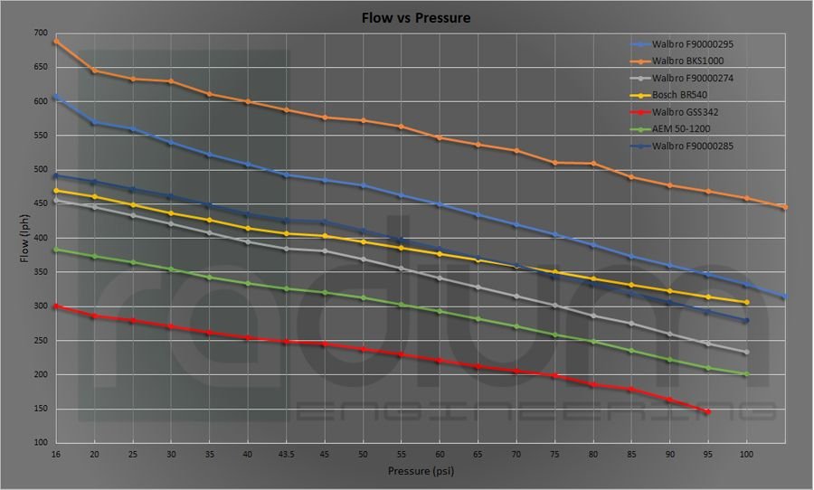

Wanted to bump this to say there is a new pump out, F90000295, that draws much less current than the F90000285 but also outflows it!
One thing to note is that it does not have an internal check valve, if that matters to you.
http://www.radiumauto.com/Blog/Post/...-Pump-Test-100
Impressive, and I'm glad its out there. Unfortunately, I don't see how the factory return system could ever handle that pump. Some kind of custom low/med/full pump voltage scheme would be needed to use it with the stock return line, even with a drilled out siphon.
