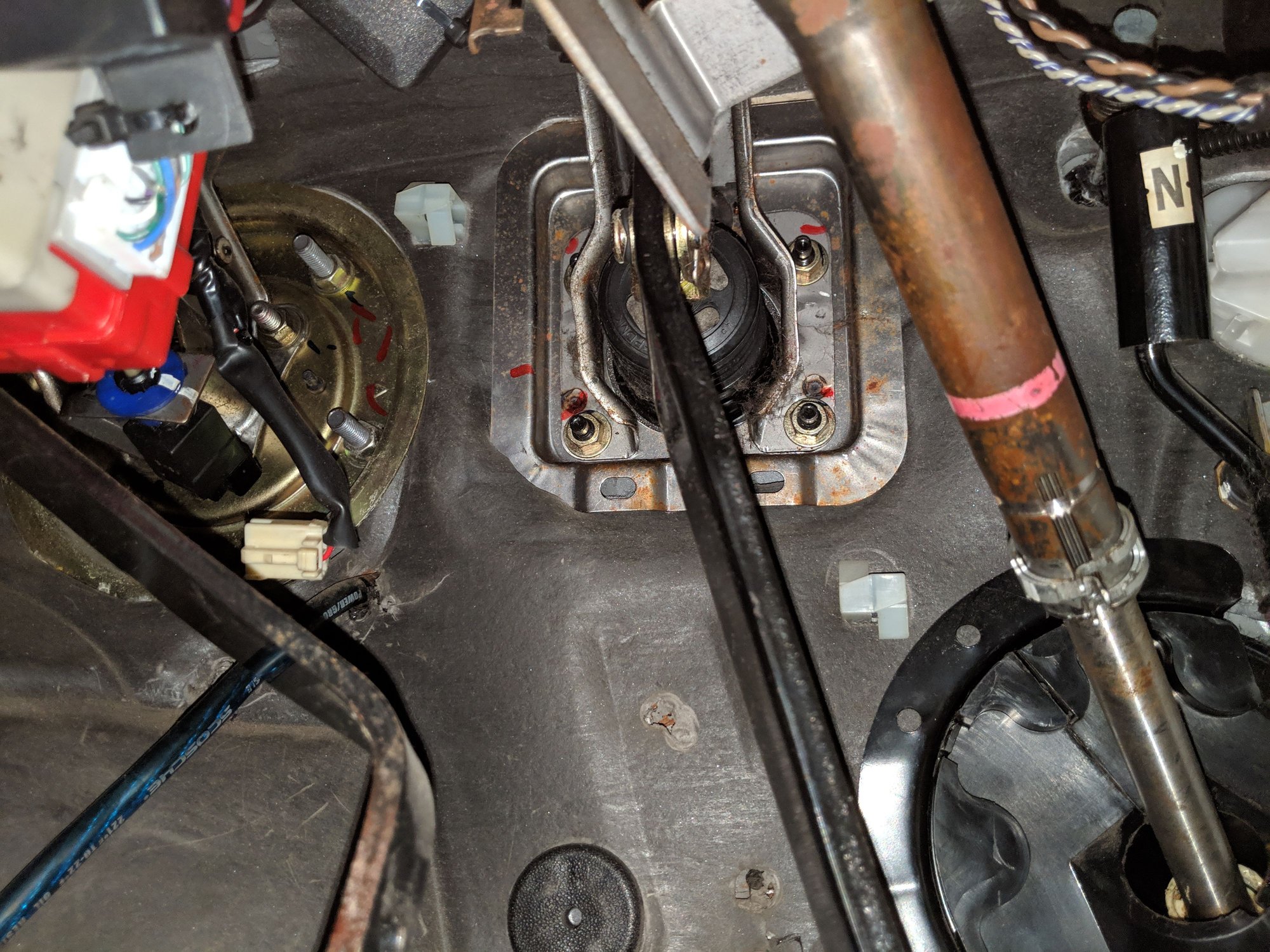

There's a noise absorption pad located on the cabin firewall around the steering column. That pad (about 5 inches in diameter) literately falls off when the steering column is pulled. When my pad fell off one day as I worked on the car I figured it wasn't doing much and cast it aside. But then I noticed increased racket from the engine compartment. So, suggest you check if yours is still present. The outline of the thing is sorta like a frog.

This is what my cabin firewall looks like at the moment.

So just as a test, I sealed up the area pretty well with some insulation material I had. I went way over-kill, and no change in noise. The tapping sound comes through way too clearly. Which got me wondering, those who own RS's that have no insulation at all which I've been in, don't have this noise at all.
