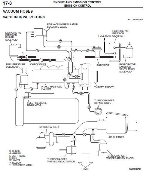

Old Jun 27, 2019 | 03:53 PM
Heres the plumbing dwg. The full file is attached as well

Old Jun 27, 2019 | 04:45 PM
LetsGetThisDone's Avatar
Joined: Oct 2013
Posts: 15,973
Likes: 1,629
Plumbing the grimmspeed is not the same as the solenoid, so that diagram doesn't apply.
