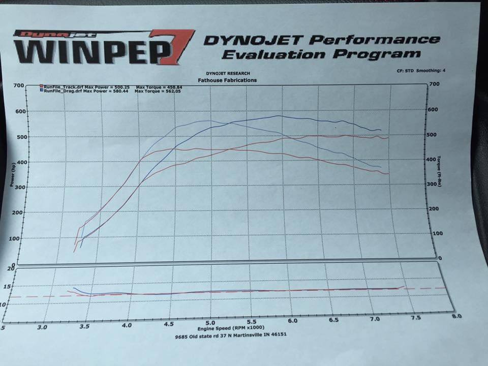

You'll find that even though the green makes boost earlier, both turbos make 300wtq right around 4-4200rpm. Where boost comes up doesn't matter, it's where the torque comes.
My car for example, stock motor, S2 cams, bolt on. This was revved to 8k on the dyno, not 8500, RPM is off because the RPM sync was done on a different car. You can see 300wtq at 4k rpm. Then hits the intentionally limited 375ftlbs at about 44-4500, and is allowing to leak a bit higher later on.
The pull before this it made 420wtq at 4400, but we backed it off for safety. Since you have a built motor, you won't have to do that. Also, because this was a stock engine, timing is soft in the spool up area and below 5k to help keep things together. On a built motor, you will have less "lag".
I never had any issues with lag or response when doing role races in Mexico or having fun in the canyons with this setup.
If you want 9 turbo response with some more power, you need a 71hta. If you want more than that, moving up to a red is the best decision.

The best 7163 dynojet results I've seen. Its on a 2.3 so that will spool faster then a 2.2/2.0. It seems to taper more at high rpm then the red if you look at the graph from 6000 on.
https://www.evolutionm.net/forums/ev...3-dynojet.html
My 2.2 red setup
The EFR series is neat but keeping a stock frame turbo would be easier. Concerning smaller turbo's, These engines can only process so much air so having xxx psi at 3300 will only work so well and compressor surge is a possibility.
The red will make around 400 ft lbs (mivec engine) at 4000 if you want it to.
There are also some good results with the new Garrett turbo's.
Lots of good options out there .
